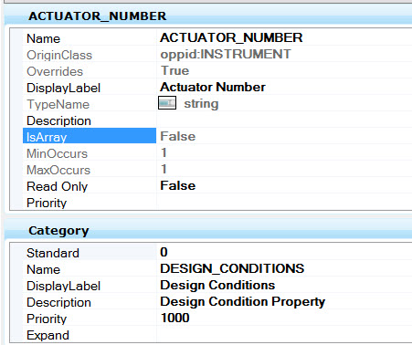

  3. Go to Instrument class and create new property 'ACTUATOR_NUMBER.

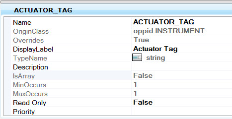

  4. Create another property ACTUATOR_TAG on Instrument class.

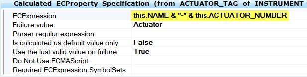

  5. Add a Calculated EC Property Specification attribute on ACTUATOR_TAG property and set EC Expression as highlighted below.

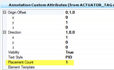

  6. Add Annotation Custom Attribute and set the count to 1.

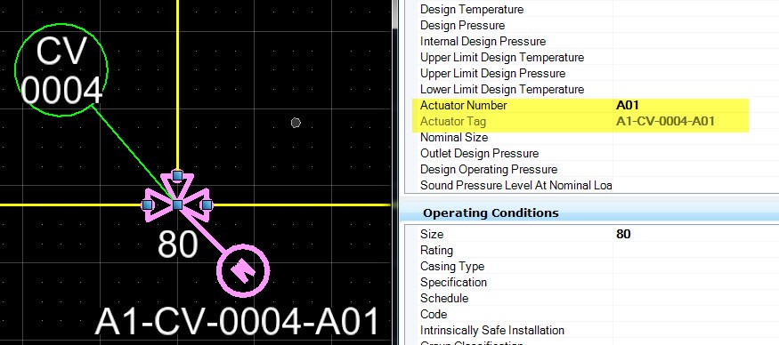

  7. Save the changes in schema and verify the result in OPPID.
