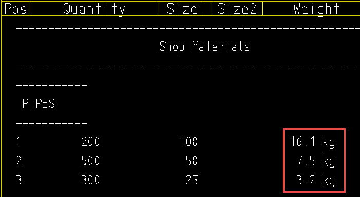

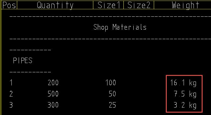

There could be requirement to get weight accumulated for the components and round up quantity in bill of material. Below are some simple steps to accomplish this necessity.
For OpenPlant Modeler - OpenPlant Isometrics Manager
  1. Navigate to the project path and open required style's "config" folder in which all style's configuration files are stored. By default this folder can be found at this location:
    C:\ProgramData\Bentley\OpenPlantModeler V8i\WorkSpace\Projects\[..Project-Name..]\DataSet\Isometrics\Styles\IFC\Confi
  2. Open report.def file and add new COLUMN entry to present "DRY_WEIGHT" attribute as shown below.
    REPORT = SHP
        INCLUDE = IE_FIELD = 0
        EXCLUDE = IE_TYPE = CT_WELD
        COLUMN =  3 : R : PARTID
        COLUMN = 19 : C : QUANTITY
        COLUMN =  7 : R : SIZE1
        COLUMN =  7 : R : SIZE2
        COLUMN =  2 :   :
        COLUMN = 10 : RA1 : DRY_WEIGHT
        COLUMN = 2 : L : "kg"
        COLUMN = 60: W : IE_DESCRIPT
        GROUP  = PARTID
        SORT   = PARTID:N
        SEP    = @
        SORTHEADERS = 1
        TEXT = @ ----------------------------------------------------------
        TEXT = @                       Shop Materials
        Write =
    END

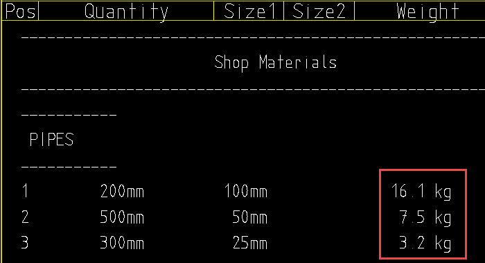

    NOTE: additional columns can be added to present units type for required attributes. In this Metric Project's example, a kilo units where attached for DRY_WEIGHT attribute.
  3. Generate isometric and verify result.

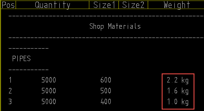

For AutoPLANT Modeler - OpenPlant Isometrics Manager
    C:\ProgramData\Bentley\Plant V8i\Bentley Plant V8i Projects\[..Project-Name..]\Config\OpenPlant\Isometrics\styles\IFC\config
  2. Open report.def file and add new COLUMN entry to present "WEIGHT" attribute as shown below.
    REPORT = SHP
        COLUMN =  2 :   :
        COLUMN = 10 : RA1 : WEIGHT
        GROUP  = PARTID
        SORT   = PARTID:N
        SEP    = @
        SORTHEADERS = 1
        Write =
    END
    NOTE: additional columns can be added to present units type for required attributes. In this Metric Project's example, a kilo units where attached for WEIGHT attribute.
