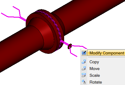

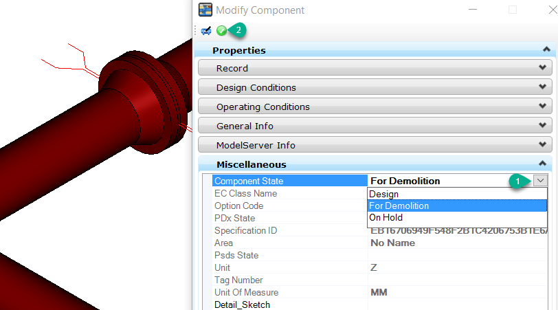

  1. In Open Plant Modeler. Select piping systems that needs to separate components for setting new scope.
  2. Right click on gasket & select ‘Modify Component’ option as shown.

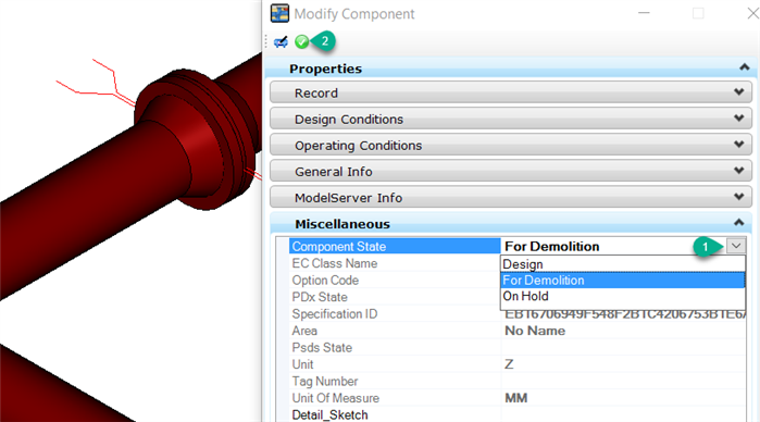

  3. From dialog box, set the ‘component state to ‘For Demolition’. See image below.
  4. Save & close the dialog.

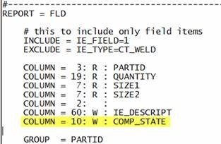

  6. Launch Configuration Manager dialog box and from ‘Advanced’ node option, click on ‘Report Definition’ option to open Report file.
  7. Modify report definition, for Field type by adding property COMP_STATE as shown below.
  8. Save & close report file.

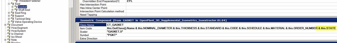

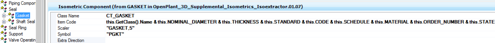

  9. Using Class editor, open ‘OpenPlant_3D_Supplemental_Isometrics_Isoextractor.01.04.ecschema’.
  10. Locate the 'BOLT' & ‘GASKET’ class to edit the schema.
  11. User need to add this.STATE property in isometric component custom attribute to Item Code field for both gasket & Bolts as shown in below image.
    For Gasket
    Item Code:
    this.GetClass().Name & this.NOMINAL_DIAMETER & this.THICKNESS & this.STANDARD & this.CODE & this.SCHEDULE & this.MATERIAL & this.ORDER_NUMBER & this.STATE

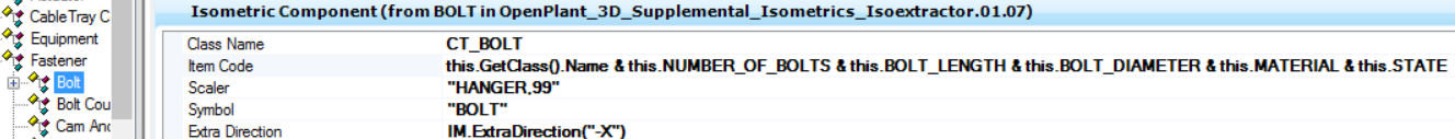

    For Bolt
    Item Code: this.GetClass().Name & this.NUMBER_OF_BOLTS & this.BOLT_LENGTH & this.BOLT_DIAMETER & this.MATERIAL & this.STATE

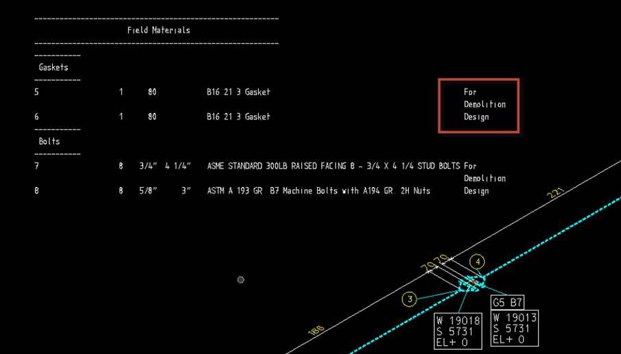

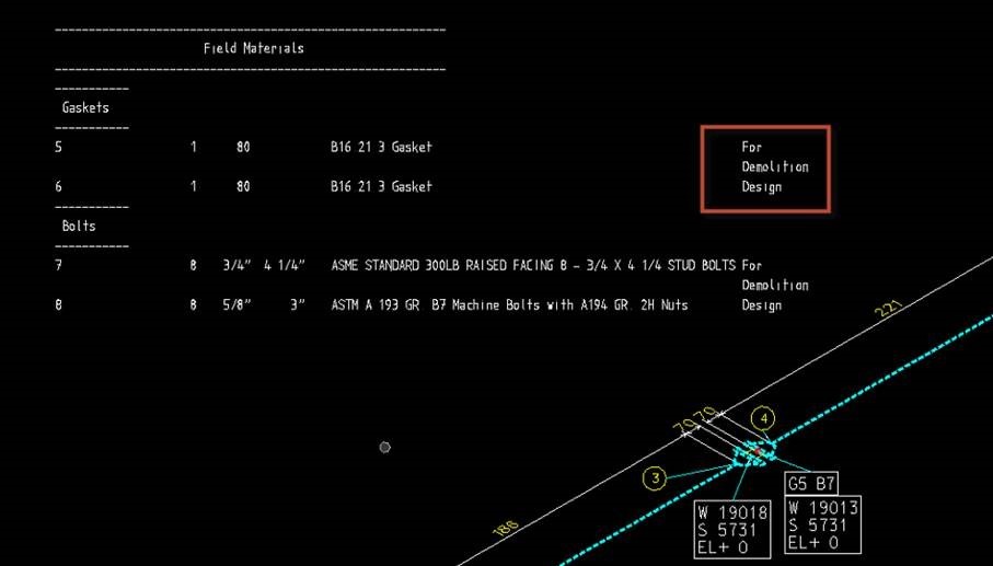

  12. It will differentiate the same material list based on STATE property added in this field.
  13. Generate Isometrics and verify results.
