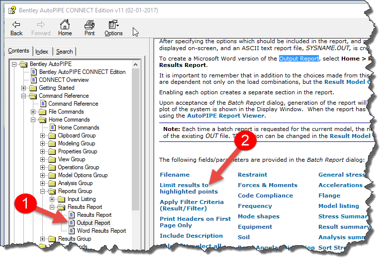

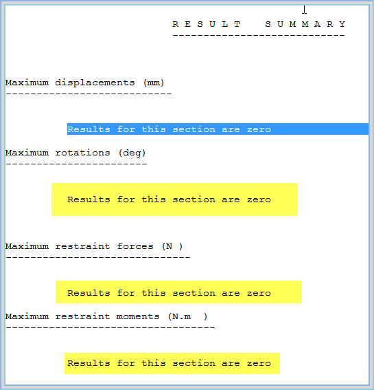

"Results for this section are zero" appears in the Results Summary of an output report when using AutoPIPE, why?

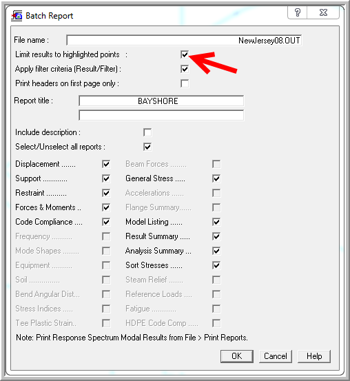

 Confirm that "Limit results to highlighted points" is unchecked, before creating an output report.
The output report was only limited to the highlighted points, if there are no highlighted points than the report is blank.
Avoidance #1: Select (highlight) some node points in the model before creating an output report
or
Avoidance #2: Uncheck (disable) "Limit results to highlighted points".

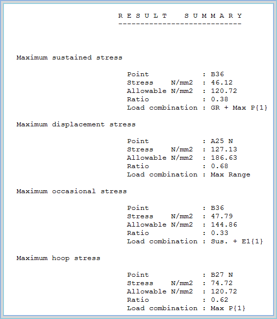

Using both options will have the same affect, report will now contain the correct Max values, see below for example
See online help for complete details on this option.

"Result Summary" sub-report using Results> Output Report
