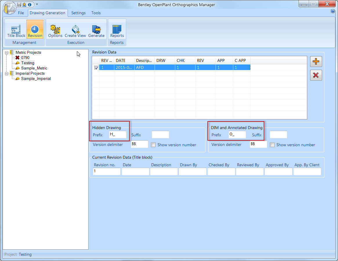

There are quite some settings available to configure OpenPLANT Orthographics manager output naming convention. This wiki shows how to remove the default prefix which gets added to the output drawing name.
Before creating drawing go to the revision tab as below and remove the prefix entry from hidden Drawing and DIM and Annotated Drawing to get desired output.

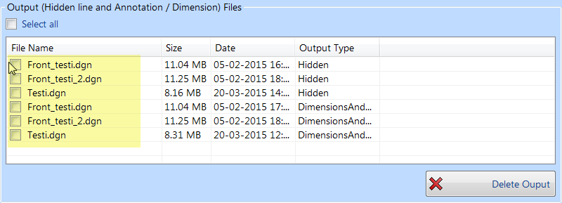

See below Output without prefix characters
