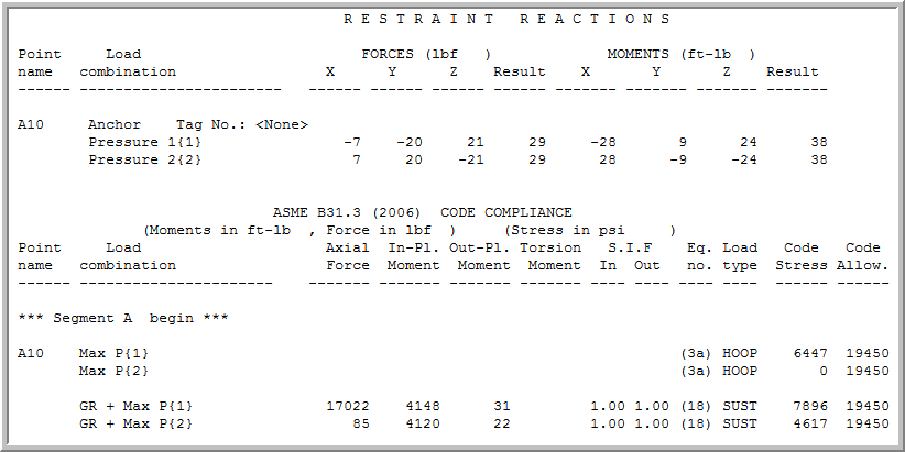

Here is an example of applying a second pressure case in example model WALKTHRU using P1=300 psi and P2=-300 psi
Notice Forces/Moments for P2 case is opposite to P1 case.
Notice that HOOP check gives zero stress for negative pressure P2
Sustained stress for negative pressure is reduced in this case due to reduction in Axial force.
