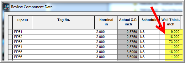

After importing a model the pipe wall thickness values were found to be very large compared to the pipe size:
why does this occur and how to avoid it?

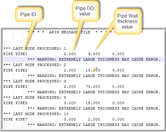

Let us look at the *.MSG file message that was displayed during the import:
As can be seen in the *.MSG file the  following warning was displayed multiple times:
*** Warning: Extremely Large Thickness May Cause Error

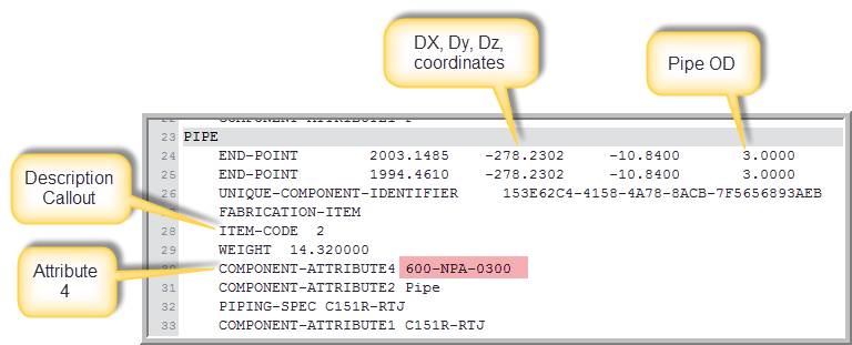

Open the actual *. PCF file that was imported in NotePad, and search for "PIPE":
Note the Call out description = "Item-Code 2"
Now perform a new search in the file for "Item-Code 2", (typically located near the bottom of the file):
Open program Help /  manual:
See section on Mappings - Attributes, note that the wall thickness information in a PCF file format would be located in COMPONENT ATTRIBUTE 4.
Look back in the actual PCF file for information mapped in COMPONENT ATTRIBUTE 4 = 600-NPA-0300
Therefore, what ever application created this has used Component Attribute 4 for another purpose than what the PCF translator has been set up to handle, The PCF translator will try to read this attribute information as a wall thickness (ex. wall thickness = 600).
Workaround:
Update program creating the PCF file to correctly export the wall thickness to Component Attribute 4 or manually update the PCF file Attribute 4 data as needed.
