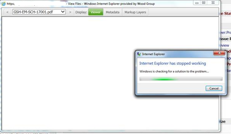

Internet Explorer crashes when a user tries to open a document in Brava!
How to Avoid

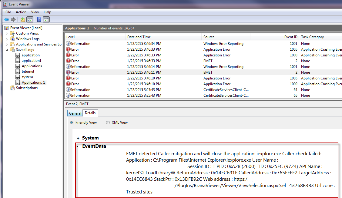

  1. In Event Viewer click on arrow near "Windows Logs" folder and select "Application”.
    If in event log there is similar error as in screenshot below.
    then for fixing this issue you need to  uninstall Microsoft EMET.
