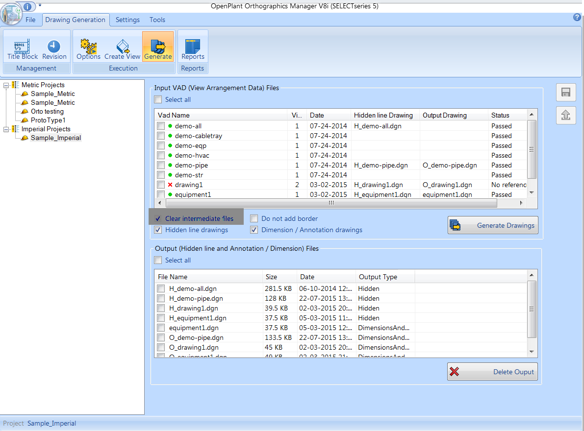

When generating Orthographic drawings alongside OpenPLANT Modeler it is essential to make sure most updated input will be used by Orthographic engine. It sometimes can happen that changes were done to the source file but the Orthographic engine does not use the updated model for generation.
To avoid this type of scenario’s make sure to enable “clear intermediate files” option prior to generate drawings. Please see below Image

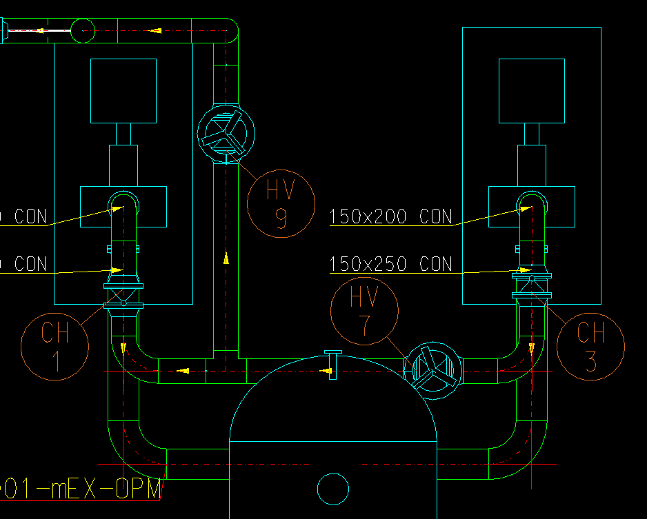

See below valves, pipes, tees and other components missing in the orthographic drawing

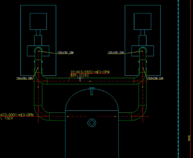

Results after clearing Intermediate files:
