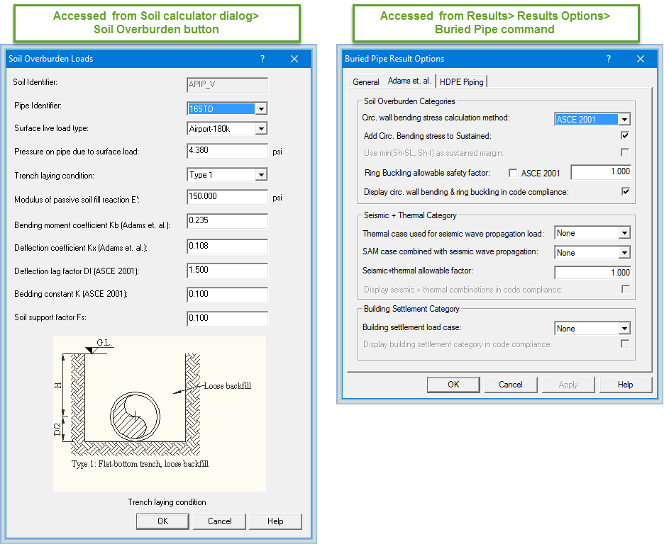

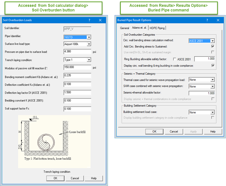

B. Soil Over Burden issues & Buried Pipe Result Options:
Note:
1. These dialogs are only available for the following piping code years:
a. B31.1-2004 or higher
b. ASME B31.4 Liquid Trans. 2004 or higher when ASME CC N-755-1 (HDPE) option was enabled.
c. ASME B31.8 Gas Trans. & Dist 2004 or higher when ASME CC N-755-1 (HDPE) option was enabled.
d. ASME NC 2004 or higher
d. ASME NC 2004 or higher .
2. See AutoPIPE help for reference to Adams et. al.
  1. Soil Overburden and Seismic Wave Propagation in AutoPIPE
  2. Soil Overburden : dialog does not retain the entered inputs for the Soil Overburden Categories, why?
