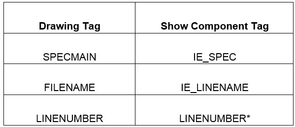

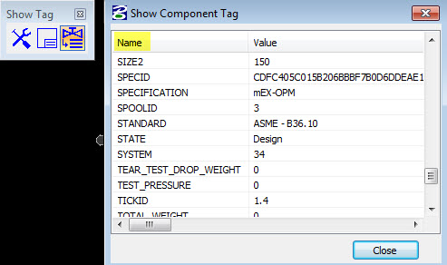

In user’s customized environment, default spool labels was not required and wanted to use some attributes on it along with CUTID’s. These attribute can be extracted from the data present under ‘Show Component Tag’.
User has taken some information from Drawing Tag data and hence some information was missing from it. One easiest way doing this is to check what similar value has been populated between ‘Drawing Tag’ And ‘Show Component Tag’. See some sample attributes to check:
Note – For LINENUMBER, writing this attribute directly on user labels does not put zero initials as 001, 002, 003 etc and keep writing as 1,2,3 and so on. See results:
Spool Labels Tried by user: $(SPECMAIN)-$(FILE_NAME)-$(SERVICE)-$(LINENUMBER)-$(CUTID)

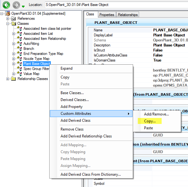

  2. Navigate to Class ‘Plant Base Object’. Right click as shown below.

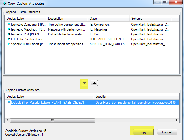

  3. Copy Custom Attribute ‘Default Bill of material labels’ as below.

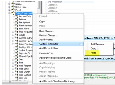

  4. Navigate to Piping Component class and paste as below.

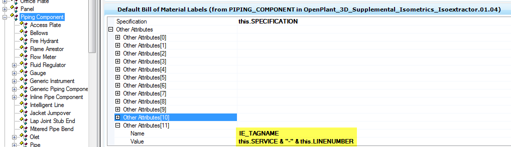

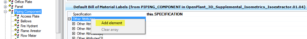

  5. Default Bill of Material will get enabled. Add Element and create new attribute like shown in image below:

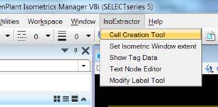

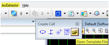

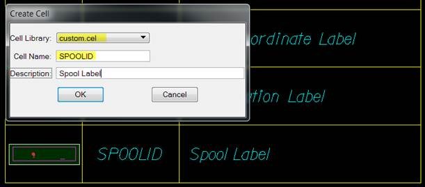

  9. Using ‘IsoExtractor’ option click on ‘Cell Creation tool’.

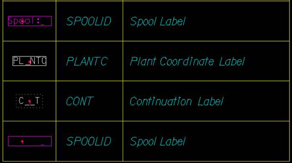

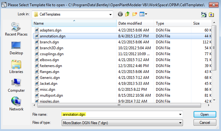

  10. Open ‘Annotation’ DGN file to edit the SpoolID table.

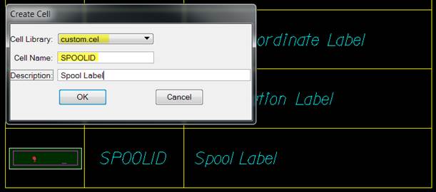

  11. Under Notes table, copy SPOOLID cell below the table. Delete the Text Spool: from the box.
  12. Place fence around the box and save the new cell to custom.cel.
  13. Save settings and close cell template DGN file.

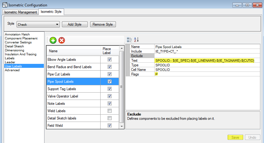

  14. Open ‘Isometrics Configuration’ dialog and select ‘Isometric Style Tab.
  15. Under user Labels, select Pipe Spool Labels and Type the Text as mentioned below.
    SPOOLID:- $(IE_SPEC)-$(IE_LINENAME)-$(IE_TAGNAME)-$(CUTID)

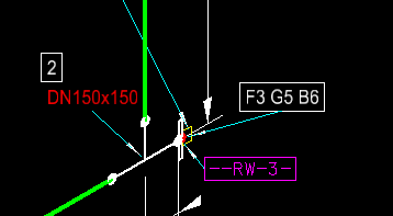

  16. Generate isometric and verify results. It will assign spools as per CUTID and other attributes.
