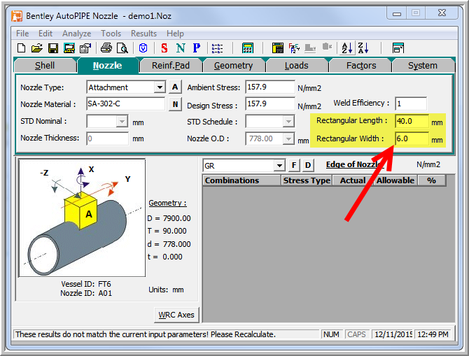

What is the formula's used to calculate  C1 and C2 on the attachment dialog of AutoPIPE nozzle?
Please see the following AutoPIPE help section:
Help > Contents> Contents Tab> AutoPIPE Nozzle> Nozzle> Nozzle Type> hyperlink to "Attachment"
Under the picture of the different attachment types see the following:
Starting with the top left figure and moving around clockwise, the C1 and C2 values are calculated as follows:
Again, see AutoPIPE Nozzle help for details
The results of C1 and C2 will be used to update the Rectangular Width and Rectangular Length of the attachment.
