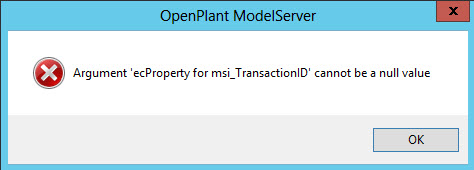

Error: Argument 'ecProperty for msi_TransactionID' cannot be a null value
Product(s):OpenPlant ModelServer
Version(s):08.11.11.395
Environment:Windows 7/8 (64 bit)
Area:Projectwise
Subarea:
Original Author:Harpreet Singh, Bentley Product Advantage Group
User getting below error when trying to connect to OpenPlant Modelserver.
Reason
This error generally occurs when the server schemas have been updated and user has opened the existing working file with some referenced out/checked out components or no components.
Steps to Resolve
  1. Create a new working file and discard the old working file.
  2. Delete the temporary pw working directory and reload the managed workspace.
Please Note: This error should not occur and therefore this has been logged as a defect in our backlog.
Still a Problem
If there is still some problem and you cannot connect to OPMS after trying the above two suggestions, then please create a Service Request and contact Bentley Product Advantage group along with the list of all relevant details to get in depth analysis and for possible solution or workarounds.
