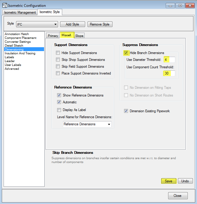

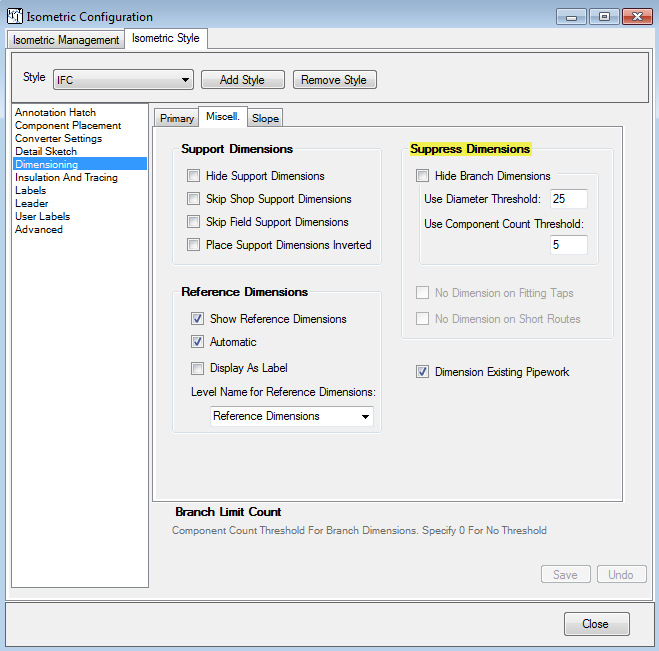

  3. From "Isometric Configuration" Dialog > Dimensioning > Miscell. Tab, Check Suppress Dimension.
  4. Check on Hide Branch Dimension and set threshold values to Dimeter and number of components.
    Note – The value can be specified in decimal or millimeters. The conversion factor user is 25.
  5. Setting "Use Diameter Threshold" value will suppress branch dimension when the diameter is below specified value.
  6. With Option "Use Component Count Threshold", it suppresses those branch dimension whose count is below specified value.
  7. With the current requirement to suppress 4” below size and less than 30 components, we have changed the values.
  8. Save the settings and generate isometric drawing and verify results.

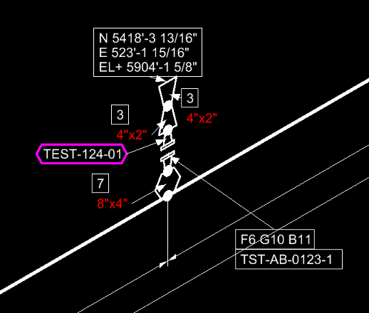

    Before Suppress:

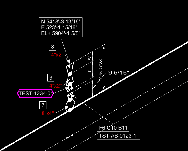

    After Suppress:
