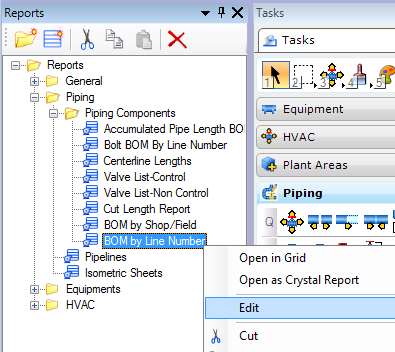

  2. Go to OpenPlant Modeler>Tools>Item Reports.
  3. From Piping>Piping Component, select BOM type BOM by Line Number.
  4. Right click on it, Select ‘Edit’.

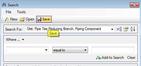

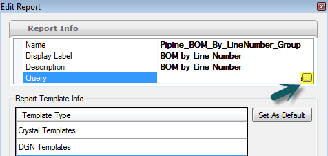

  5. Click on browse option for Querying.

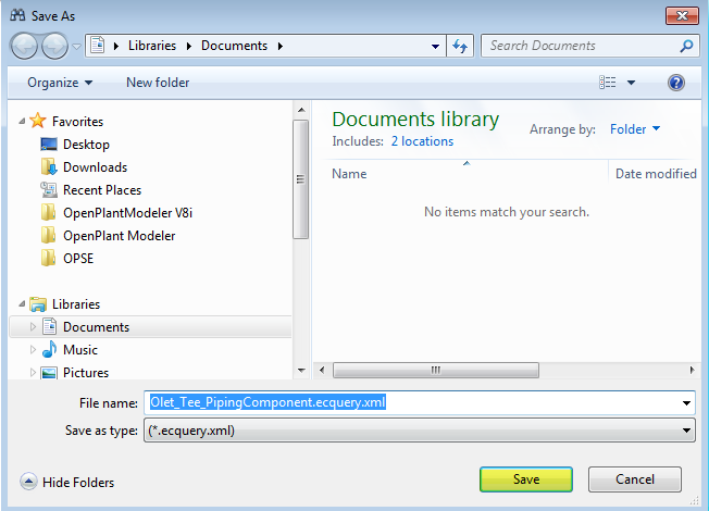

  6. Select multiple component and hit “save” like shown in below image.
  7. Give some logical name to recognize the type of report.

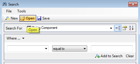

  8. Launch another project with a different unit.
  9. Reuse same saved file using open option.
