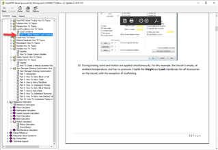

To make the calculation of a vertical vessel during the transportation horizontally, you may follow this workflow:
- run the calculation of the vessel in its vertical position
- convert results as input data (Menu/Execute/Convert Results as Input Data)
- save the model under a new name
- switch the vertical support to saddle support (Insert/Support...)
- The vessel is now in horizontal position
- remove all unnecessary load combinations
- add the transportation (aka towing) load combination from the help contents
