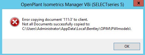

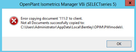

Below error shows up when loading I-model from Projectwise managed workspace in OpenPlant Isometrics Manager.
This error message usually appears when I-model is loaded from different location than default location.

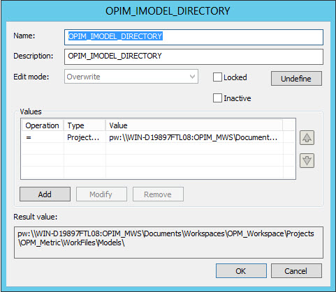

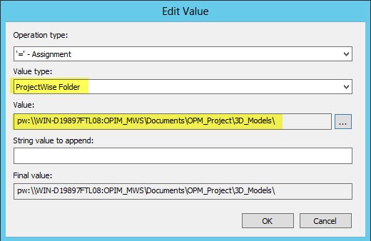

  3. Select the project CSB and add below variable into the configuration block.
    OPIM_IMODEL_DIRECTORY
  4. Set the projectwise path in the value. It should point to the folder where I-models have to be loaded from.
  5. Save the changes and re-launch OpenPlant Isometrics Manager with Managed Workspace.
  6. Load the I-model from the defined folder.
