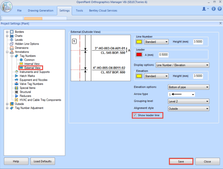

Sometimes it is required to show leader line to view dimensions in the output. It helps for better revision and provides quick reference.
  1. Enable “Show Leader line” button in Settings dialog as below image.

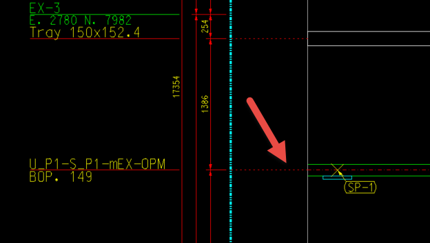

  2. Generate drawing.
  3. See below results showing dimension line.
