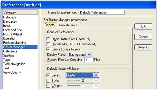

By default a raster is placed on the current active level when it is attached.  This can be changed in Microstation XM at workspace > preferences > raster manager > general > Default Raster Attributes.
Click in the checkbox next to level to toggle this option on.  Then click on the list on the right and all levels in the current dgn file will display.  You can choose one of them or select new and enter a new level name.  Hit OK to exit the dialog.  Now when a raster is attached it will attach to the level you have selected and if the level is not in the current dgn file it will be created when the raster is attached and the raster image will be placed on that level.  See the Microstation XM preferences below.

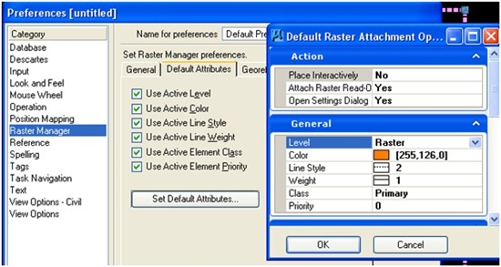

In Microstation V8i go to workspace > preferences > raster manager > Default Attributes > Set Default Attributes > General.  Here you’ll find the Level setting.  You can click in the list to the right of Level and pick a level in the current dgn file or clear the level listed and type in a new name.  See the V8i  preferences below.

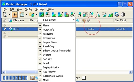

3.     In raster manager there is a column that will list the level for each raster attachment.  This column can be toggled on/off in raster manager by right clicking on the title bar just about the attached raster images’ names. The bar will have “file name”, “description”, “logical name”, and other options listed.  Right anywhere on this bar to get a list of available columns.  Check level and the level column will display.  See screenshot below.
