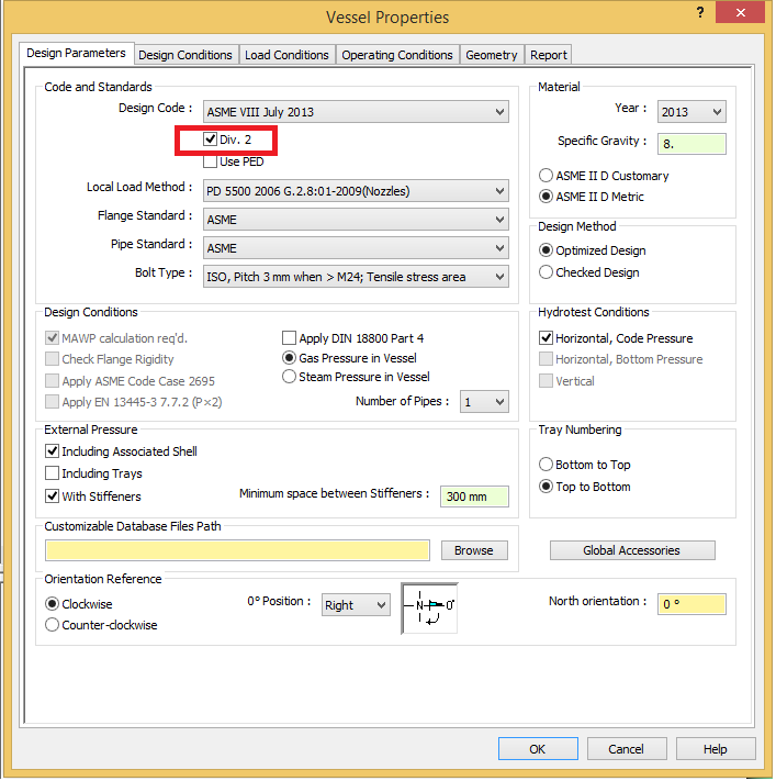

22. Why is AutoPIPE Vessel not generating rain flow calculations in the report when I run fatigue ca
Answer.
Please make sure that theĀ field "Div. 2" is checked on the Design Parameters tab under Vessel Properties in order to run fatigue calculations and display in the report:
