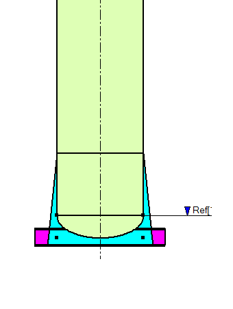

40. In a vertical vessel model with a skirt, the bottom ellipsoidal head needs to be changed to a co
Question:
How to model this correctly?

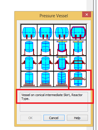

Answer:
When you start creating the model, from the model template select the option for "Intermediate Skirt" as shown below:

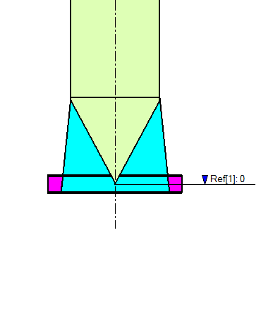

The model that appears is this:

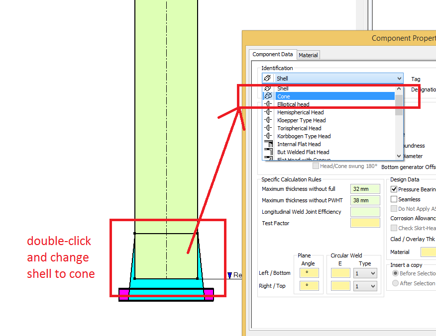

Erase the bottom ellipsoidal head and double click on the shell that lies within the skirt and change it to cone.

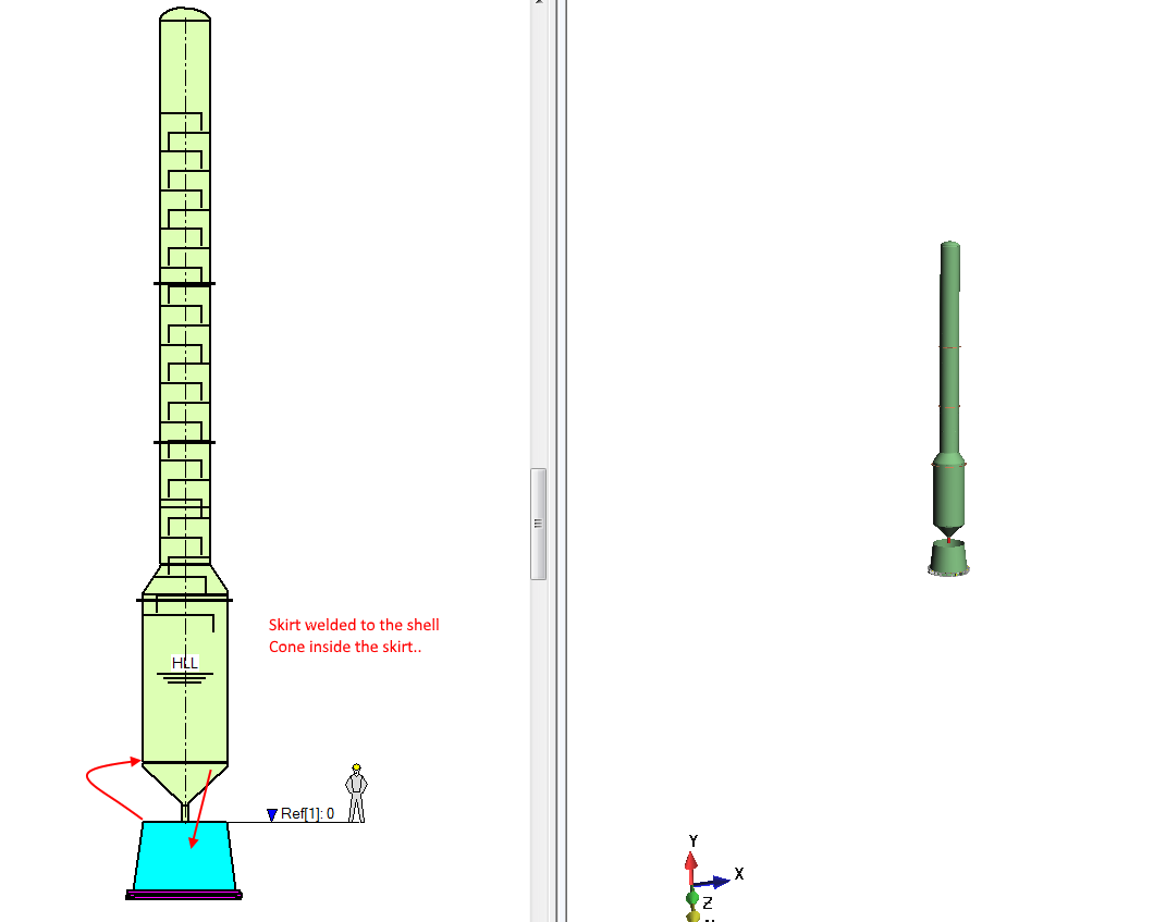

This would correctly create the model.
Modify your model accordingly.
