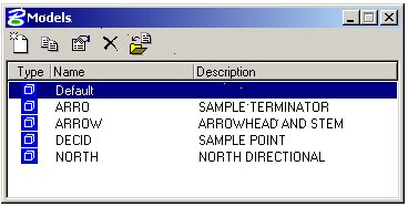

For example, open the delivered ...\Workspace\System\cell\sample2.cel as the active file. Then select File > Models and note the resulting dialog:
Before we go on, let's try and understand what a model is all about. A DGN file is now simply a "container" or "folder" that can contain both 2D and 3D objects known as models. (You may also notice that we now refer to "design files" as "DGN files"....since they contain much more information now than just your design.) This is why you can reference 3D DGN files to 2D DGN files, place 3D cells in 2D DGN file and the like. Now, each model is stored as an object within the DGN file and a DGN file can contain more than one model. Not unlike V7 design files, each model has it's own set of eight views and when you are viewing one of the views of a model it is known as the active model. Sound confusing? Not to worry, you'll have this figured out in no time at all. Just remember, that when you place elements in a DGN file, you are actually creating or working with a model. By the way, to work on one of the models of our open sample2.cel file, just double-click one of the model names in the dialog shown above.

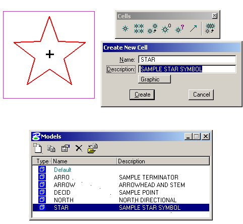

Now, why would I want to do this, you ask? Well, if you want to quickly convert a bunch of section details to, say, individual models(cells) for easier maintenance (remember, you can now edit cell definitions just as easily as DGN files!), all you have to do is identify the elements you want, place a cell origin and issue the Create Cell command. Viola! Your collection of elements just became another model in your current DGN file! Select the next bunch of elements that make up a detail, repeat the process and you have yet another model and so forth.
For practice, you can try the following little exercise in the sample2.cel file that you have open. Be sure that your active model is default and draw a new symbol. Gather up the elements with either a Fence or the Element Selection tool and then define your cell origin. Finish creating the cell and notice that you now have a new model with the same name as the cell you've just created!
