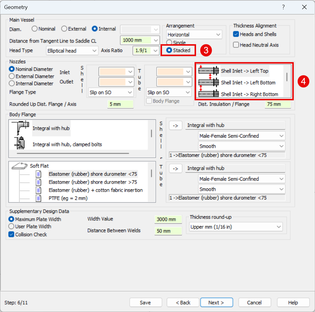

Follow the steps below to model a stacked heat exchanger in AutoPIPE Vessel:
    1. Open the Shell and Tube Heat Exchanger Properties dialog box.
    2. Navigate to the Geometry tab.
    3. Enable the Stacked option.
    4. Ensure that the inlet and outlet options are selected correctly for both the shell side and tube side, as required for stacked operation.
    5. Selecting the Stacked option automatically creates two identical heat exchangers stacked vertically, and the model should be treated as a single exchanger during the remainder of the design process.
    6. Continue modeling the exchanger as if designing a single unit, including loads, supports, and attachments.

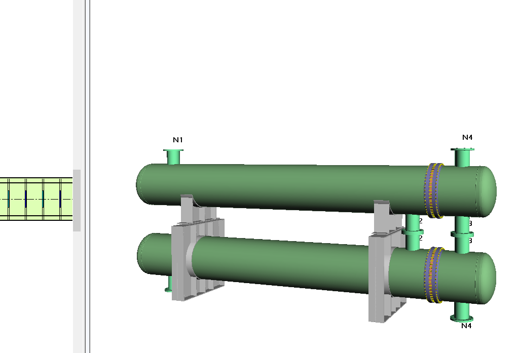

    7. Once completed, It will automatically create 2 identical exchangers stacked on top of each other as shown below:

Saddle Modeling Note
If the saddles do not appear for either the top or bottom exchanger:
    1. Open the Saddle properties for the exchanger.
    2. Select saddle option SB & ST to and click OK.
    3. Repeat for second saddle.
