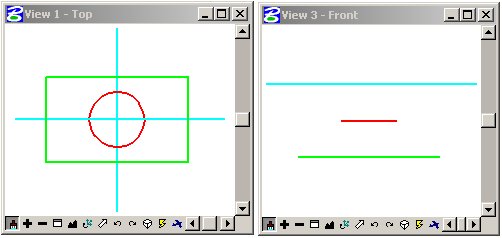

So, you've just inherited a 3D file and the elements need to be move to the same elevation (or flattened). Here are a few methods to accomplish just that.

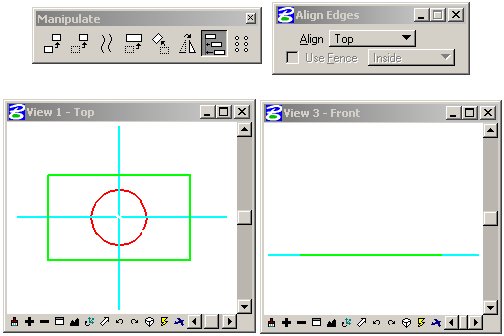

Use Align Edges:
The Align Edges tool can be found in the Manipulate tool box and can be used to quickly flatten your file. You can gather up your elements with either a Fence or put them in a Selection Set. Then activate the tool, adjust the Alignment to Top and select a Base Element. The Base Element will determine the elevation of the selected (or fenced) elements.
