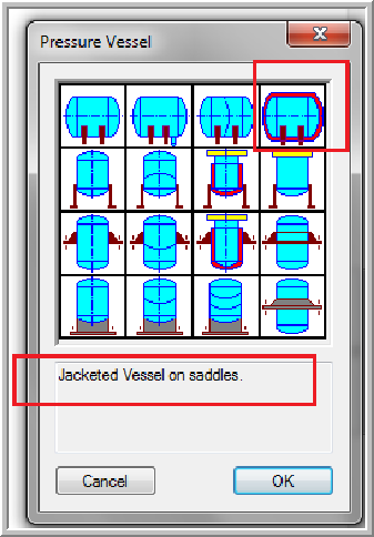

This can be done using a jacketed vessel design module that exists in AutoPIPE Vessel.

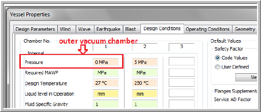

Vacuum pressure can be applied as ‘0’ external pressure on the inner vessel (chamber 2) and as ‘0’ internal design pressure for the outer vacuum chamber vessel (chamber 1).

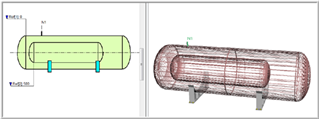

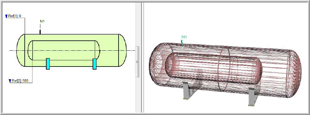

Final generated vessel 2D and 3D representation in the GUI.
