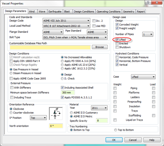

Why are there no trunnions characteristics for our vessel in AutoPIPE Vessel's output report
"Lifted" Design case must be checked:
