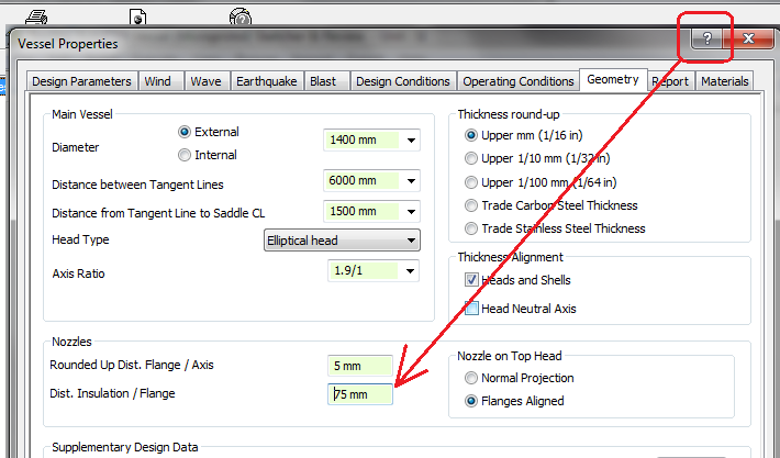

How to set the nozzle projection from the insulation surface in an AutoPIPE Vessel model?

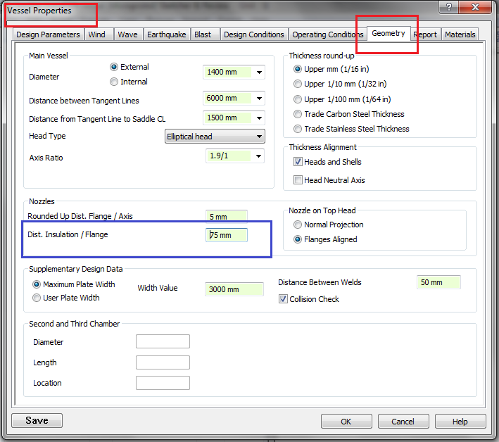

Under Vessel Properties dialog box in the Geometry tab, there is a field called Dist. Insulation/Flange where the user can set the distance of the flange face from the insulation surface.
The distance between the flange and insulation is set as 75 mm as shown in the example below.

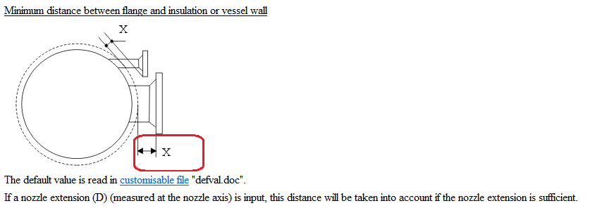

The explanation of this field is accessible in help page (shown in the third figure below) via the ‘?’ button on top right corner. Click on the ‘?’ button (as shown below) and bring the mouse cursor to the field (Dist. Insulation/ Flange) and click on the left mouse button to open the help document on this field which is shown below.
The default value for ‘X’ can be modified in the defval.doc file in the config folder.
