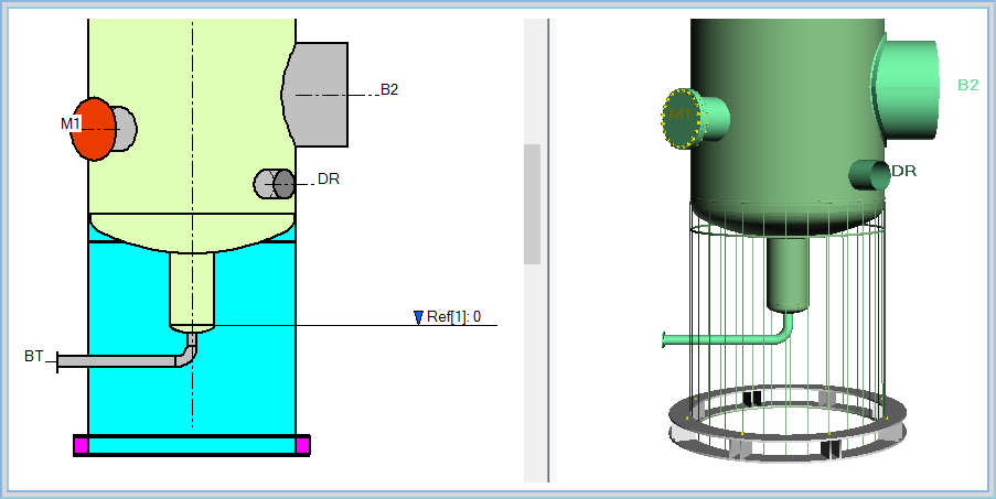

How to add a boot to a vertical vessel in AutoPIPE Vessel?
Insert a cylindrical shell before the bottom head, this will create a "transition" (different diameters).
Be careful: the reference Line (TL) will change, so the location of Nozzles should be updated (Menu Edit > Change Nozzle Location).
On the head of the boot, you can add a Goose Nozzle.
