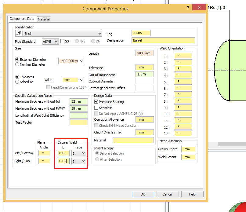

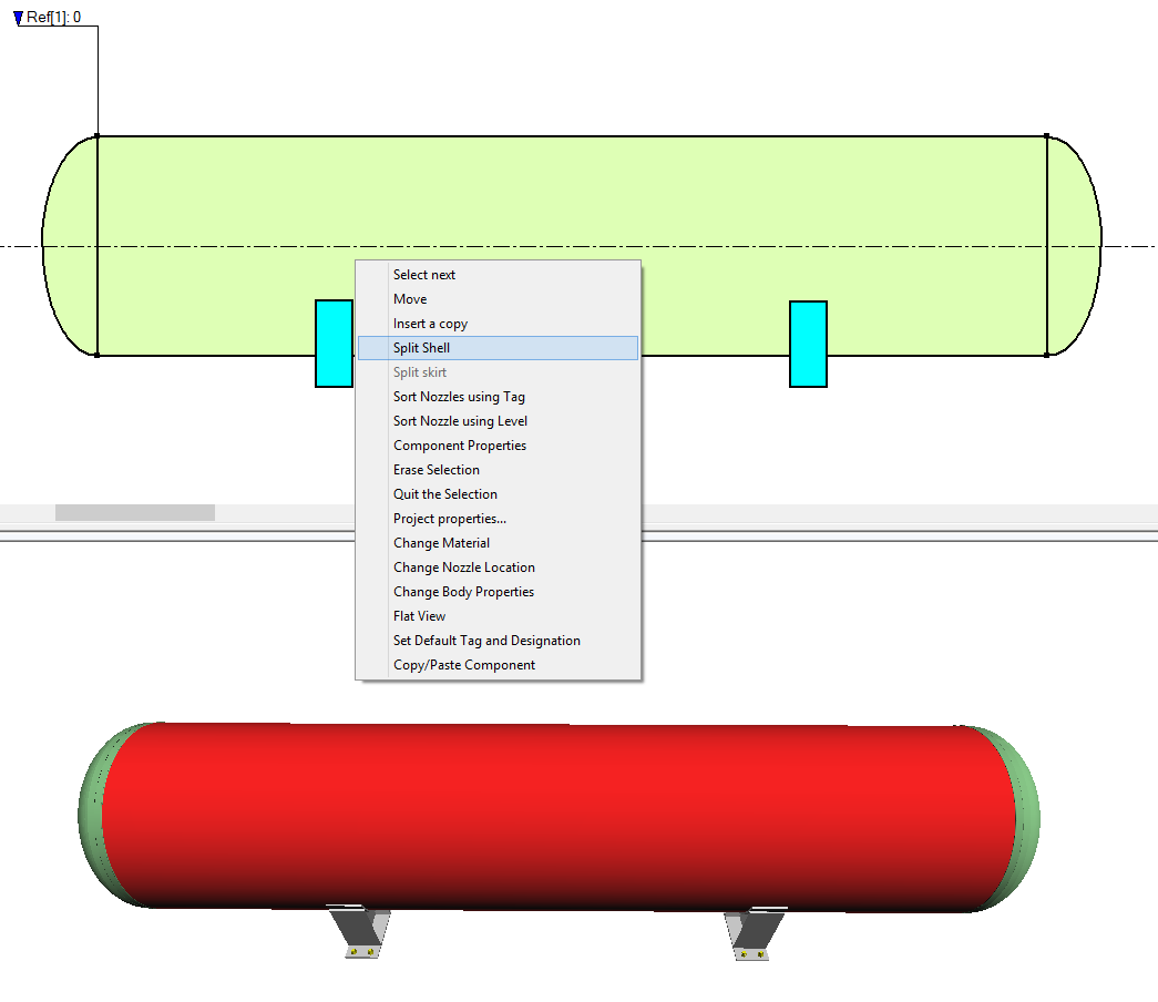

The only way to specify circular weld locationĀ is by splitting the shell into required number of shells of required length.
The circular weld joint efficiency can be specified for each shell component as shown below:
