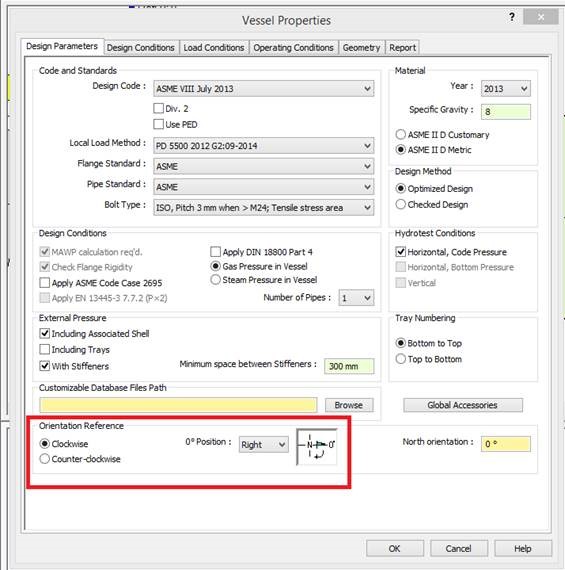

25. How can we change reference point in AutoPipe vessel while designing pressure vessel?
Answer:
It is not possible currently to change the vessel reference line, but may be considered as a future enhancement.
The nozzle orientation position reference can be set in Vessel Properties>Design Parameters:
