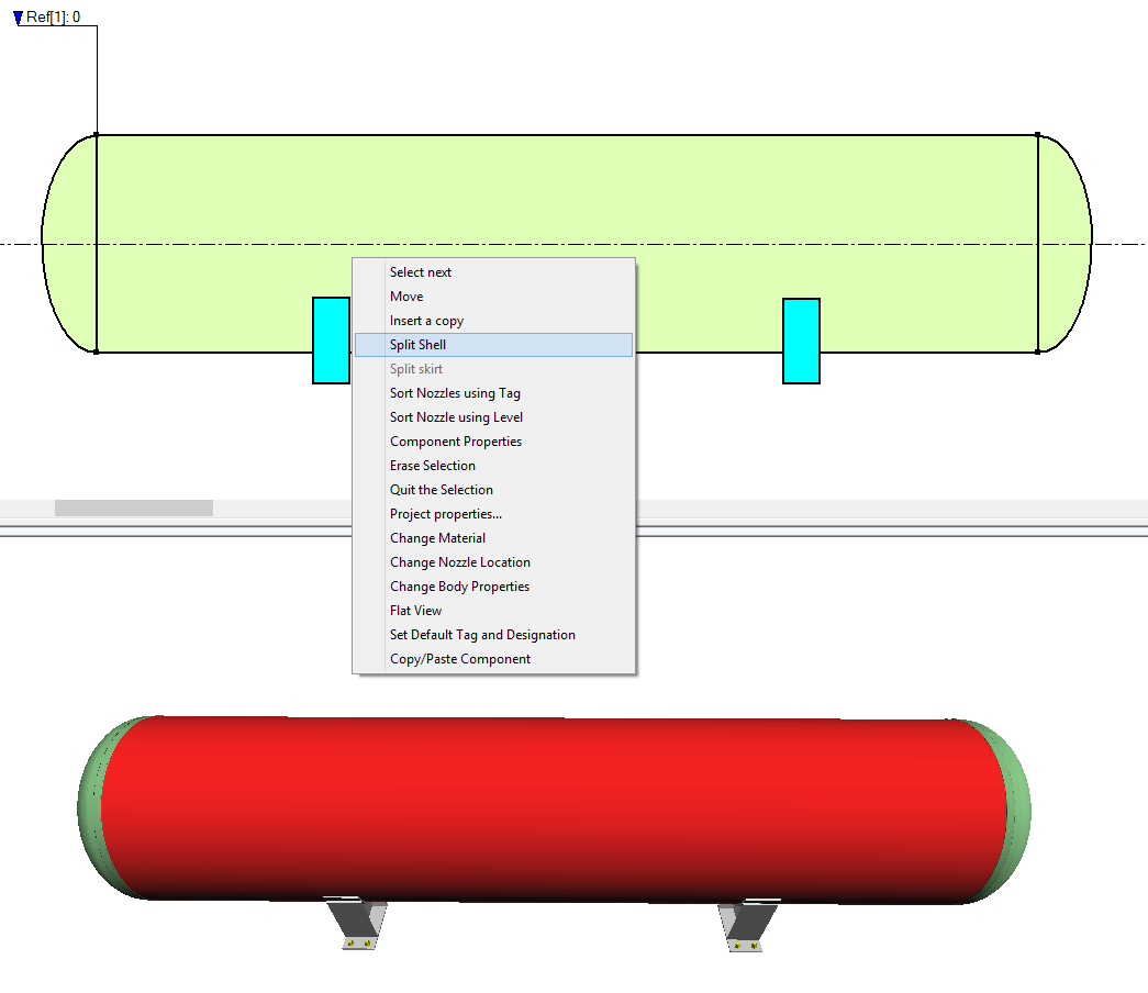

23. Can you specify different temperature zones for a vessel in AutoPIPE Vessel?
Answer:
Yes, this can be done by first splitting the vessel into the number of different temperature zones by split shell command:

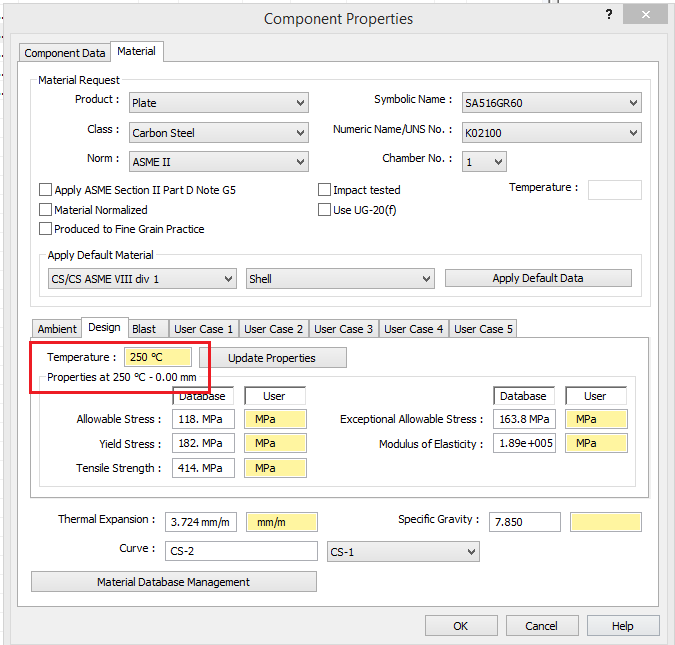

Once the shell is split, open the shell where you want to set a specific design temperature, then in the materials tab, under the design sub-tab, input the design temperature eg. 250C, then click on Update Properties:
Observe that the Properties got updated for 250C.
