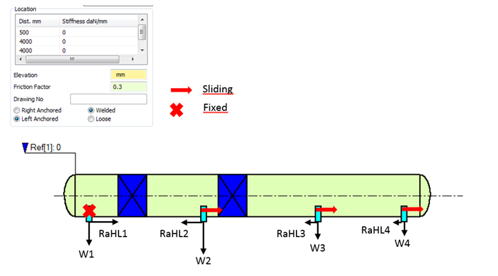

21. Saddles - Calculation of the horizontal longitudinal reactions (RaHL) When do the sliding saddle
Ans: It depends on the friction factor input in the dialog of the saddles between the sliding saddles and the concrete or the plate under the sliding saddles.
A small friction factor value indicates that a PTFE plate or in some cases rolling bars have been installed.
The values of the longitudinal loads (RaHL) are calculated as follow:

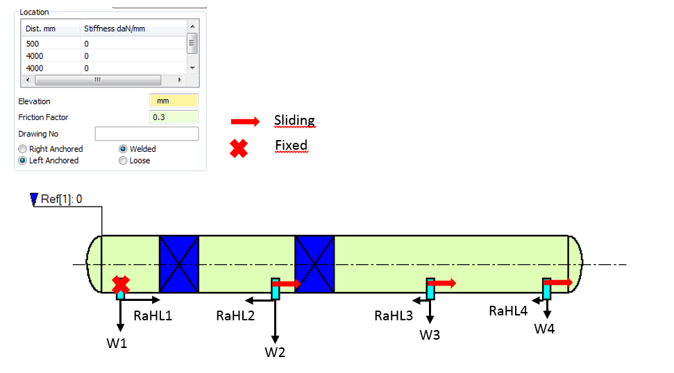

The fixed saddle is located in this example on the left hand.
 How are the RaHL values calculated? Run the model with a friction factor equal to 0 and you will obtain the values of vertical reaction loads used for the calculation of RaHL (as shown here after):

In this example, the mass of the each saddle is 181 kg (177.4 daN).
The friction factor is equal to 0.3
The loads on the sliding saddles are equal to:
W2ini = 5253.1 + 177.4 = 5430.5 daN                  RaHL2 = 5430.5 x 0.3 = 1629.2 daN
W3ini = 1559.4 + 177.4 = 1736.8 daN                 RaHL3 = 1736.8 x 0.3 = 521.1 daN
W4ini = 664 + 177.4 = 841.4 daN                         RaHL4 = 841.4 x 0.3 = 252.4 daN
The sign is – for these loads.
 The system is on equilibrium è S RaHL = 0
The load on the fixed saddle is equal to:  RaHL1 = 1629.2 + 521.1 + 252.4 = 2402.7 daN
When the longitudinal loads exist, the vertical loads are modified.
These modified values are due to the moments
