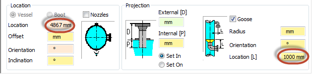

How to model a Goose neck nozzle out the bottom of a vertical vessel in AutoPIPE Vessel?
To do that the user has to input the exact level of the bottom head in the Location field of the nozzle and add a length in the Location field of the Goose:
I added a Nozzle (tag: BSN) in the model (imaged below), see the goose nozzle in the 3D view.
