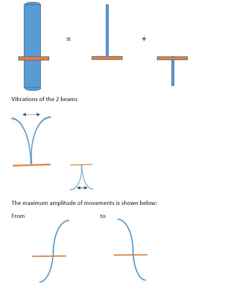

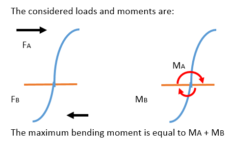

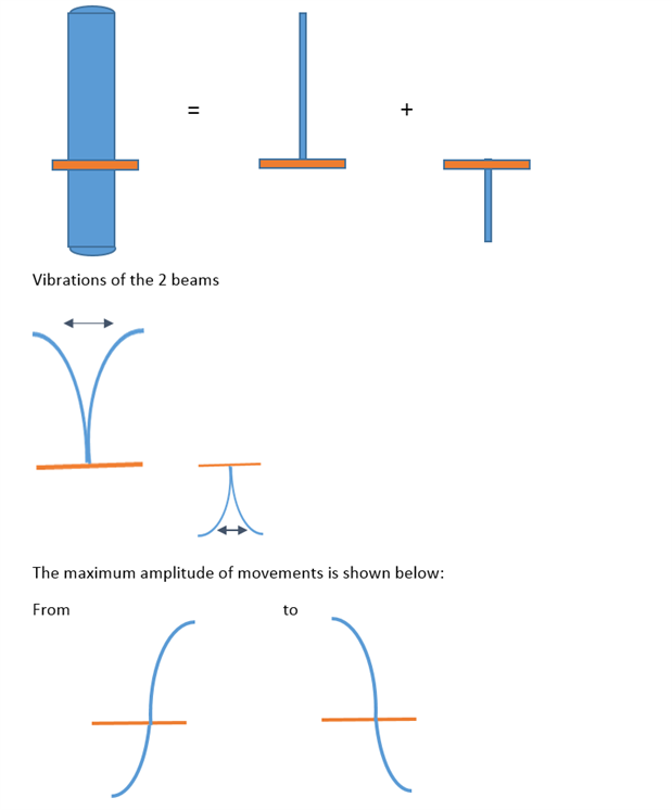

16. Consequence of the input of the elevation in the dialog of the bracket or ring
Ans: The model is constituted of 2 beams.
One is from the support to the top of the vessel and the second is from the support to the bottom of the vessel.
These 2 beams depending of their mass and their loading may have different frequencies of vibration.
