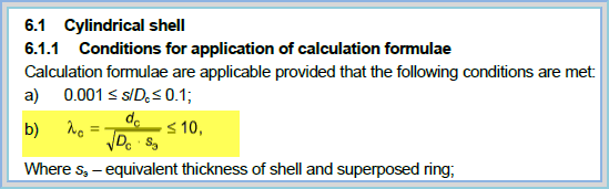

13. If dc = D2 was applicable to calculate λc only, can this relationship also be apply to equation
Product(s):AutoPIPE
Version(s):ALL;
Area:
Date Logged
& Current Version
Oct. 2017
11.01.00.23
Per GOST P 52857.3

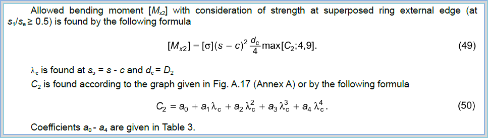

Does the program calculate Eq.49 using dc = D2?
No,
The relationship dc = D2 is only used to calculate λc as the code indicates:
Then λc is used to solve for C2, which is then used to solve Mx2 (Equation 49).
