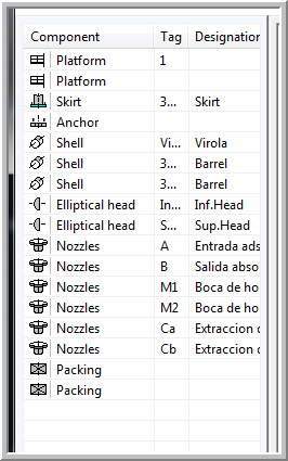

As you can see in attached design is included two(2) pakings, but in  Packing Weights summary is included three, why ??
Answer:
It seems that this model is corrupted, the first packing is defined in the data file (EMVD) but it is no longer available in the UI.
Workaround:
Perform the following procedure to update the model:
    1. Physically remove all packing from the model
    2. Close the model
    3. Reopen the model and re-insert the packing as  needed.
    4. Check the packing order is correct.
The Following has been logged TFS-D160815: GUI: packing issue : a packing is taken into account in the calculation but it is no longer available in the UI.
