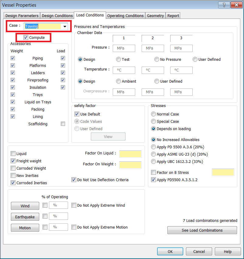

  7. Double-click anywhere around the Vessel within the 2D Sketcher to display the Vessel Properties dialog.

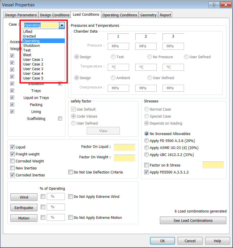

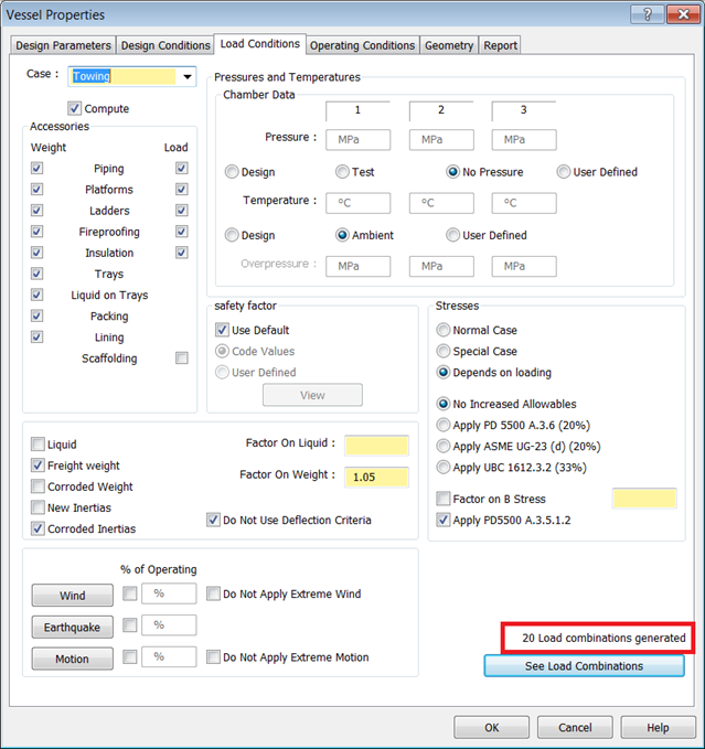

  8. Select the Load Conditions tab. Notice the Case drop-down pick-list provides pre-defined load cases provided by AutoPIPE Vessel.

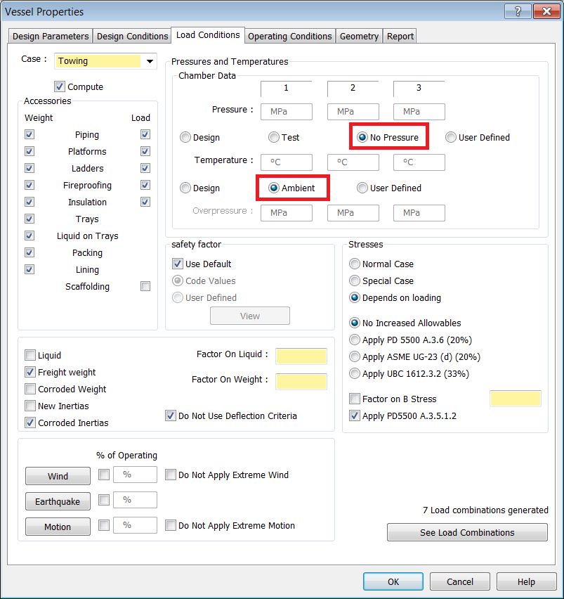

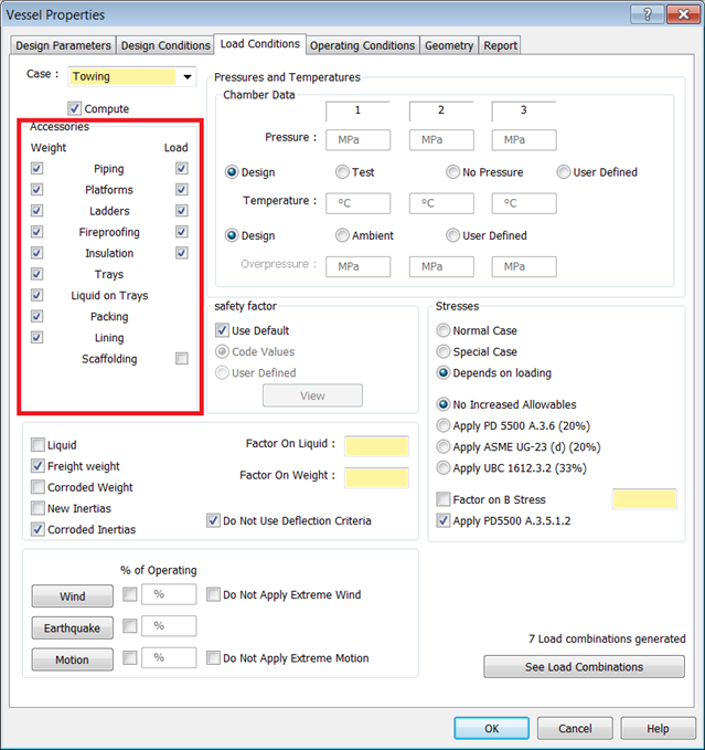

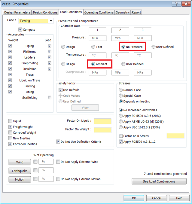

  9. Towing is not in the list of cases, but can be easily added as a user-defined case. Select User Case 1 from the Case drop-down pick-list, then enable the Compute checkbox to set the combined cases to be generated/calculated and to enable the fields within the Load Conditions tab, then type Towing.

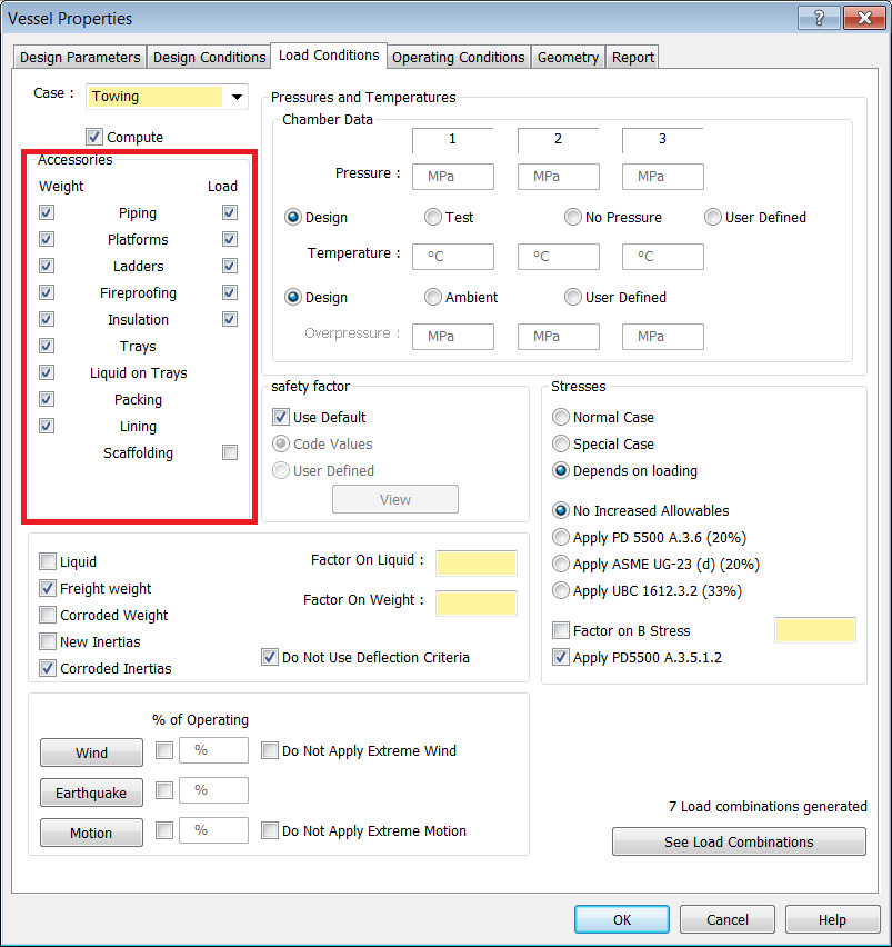

  10. During towing, wind and motion are applied simultaneously. For this example, the Vessel is empty, at ambient temperature, and has no pressure. Enable the Weight and Load checkboxes for all Accessories on the Vessel, with the exception of Scaffolding.
  11. Within the Pressures and Temperatures group-box, enable the No Pressure radio button, then enable the Ambient radio button.

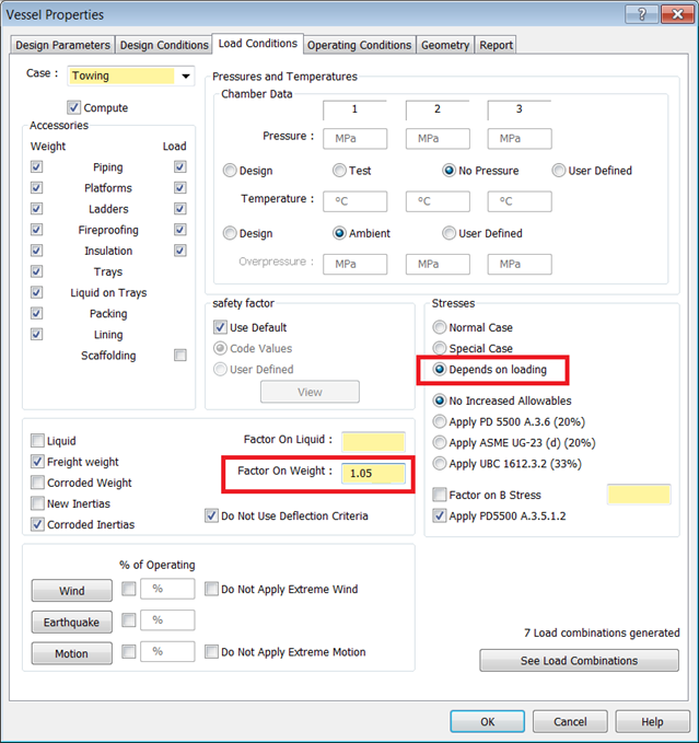

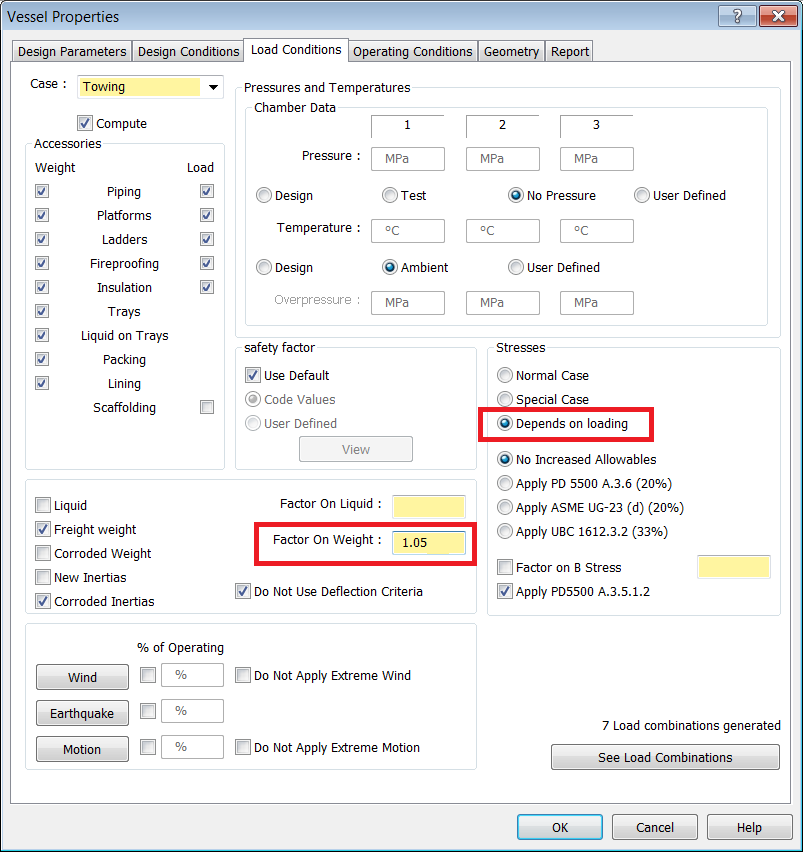

  12. For this model, normal allowable stresses will be used for combined cases except for extreme wind, extreme motion and earthquake. Within the Stresses group-box, enable the Depends on loading radio button.
  13. To apply a weight factor on the foundation loads, type 1.05 in the Factor on Weight field.

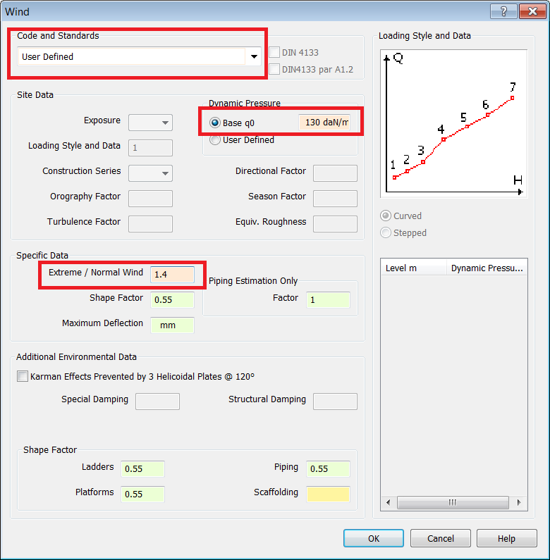

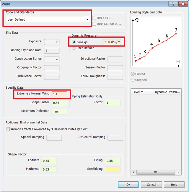

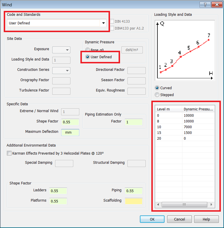

  14. You will now define the wind loads on equipment. Press Wind to display the Wind dialog.
  15. Select User Defined from the Code and Standards drop-down pick-list to define a custom wind condition.
  16. Define a Dynamic Pressure by typing 130 daN/m² in the Baseq0 field.
  17. Type 1.4 in the Extreme/Normal Wind field to define the Extreme Wind/Normal Wind ratio.
  18. Press OK.

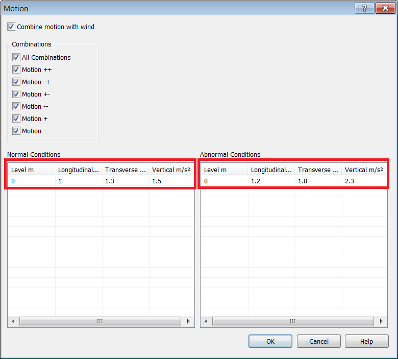

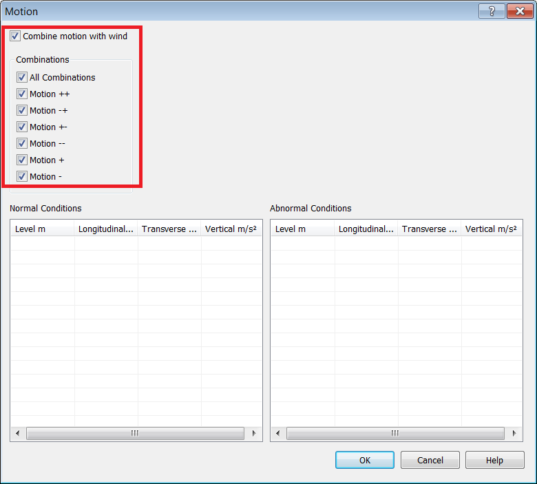

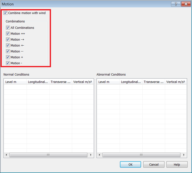

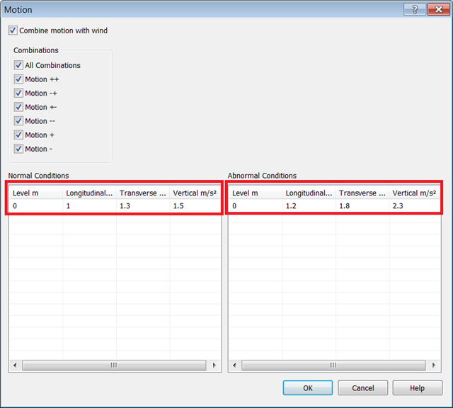

  19. Now you will specify information about normal and abnormal waves. Press Motion to display the Motion dialog.
  20. For this horizontal Vessel, all motion combinations will be calculated. Motion will also be combined with wind. Enable all available checkboxes.
  21. Define the Normal Conditions and Abnormal Conditions as shown below.
  22. Press OK.

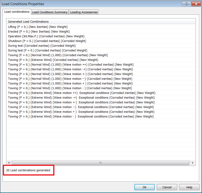

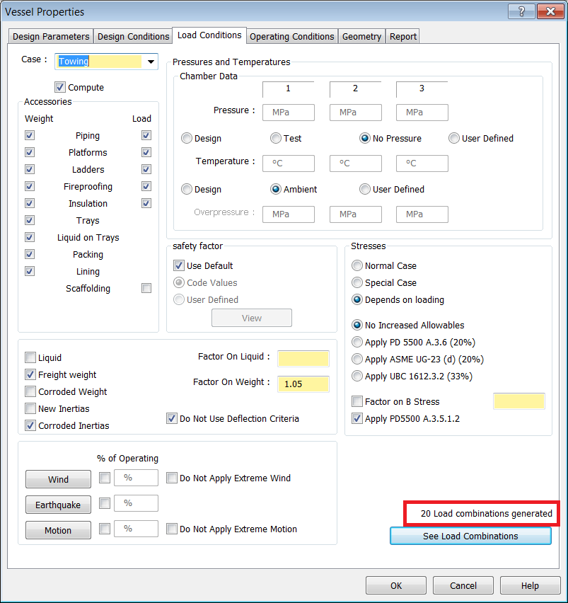

  23. Press See Load Combinations to display the Load Conditions Properties dialog.
  24. Select the Load Combinations tab, which presents a summary of all defined load combinations.
  25. Notice that 20 load combinations have now been defined. Press OK to return to the Load Conditions tab.
  26. Press OK.

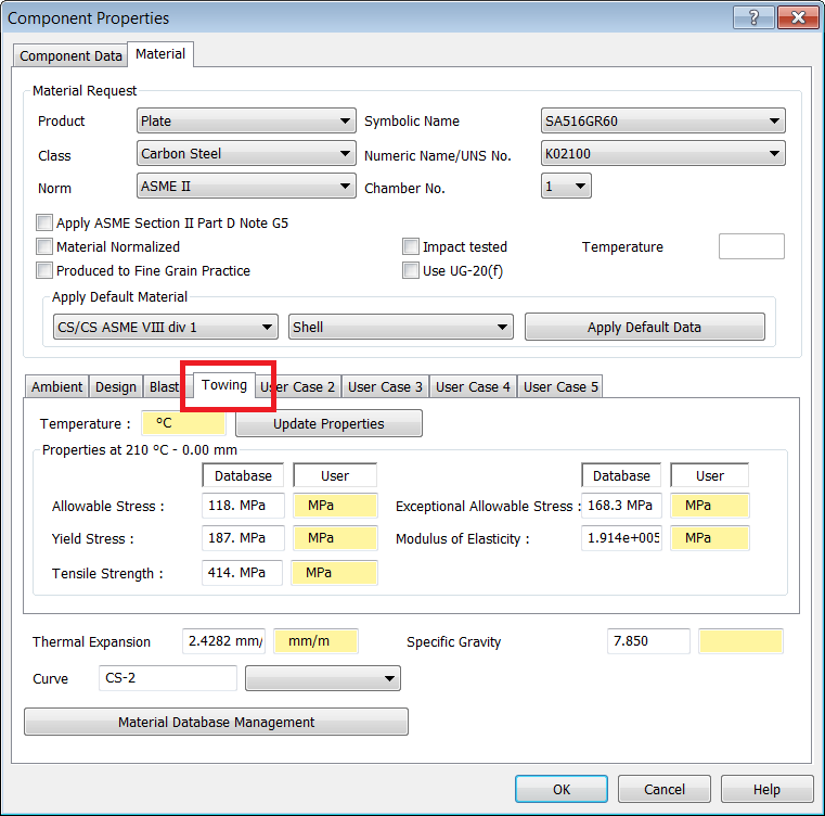

  27. Double-click on the Shell within the Components List to display the Component Properties dialog.
  28. Select the Material tab. Notice that the Towing case has been added.
  29. Press OK.

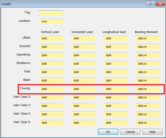

  30. Select Insert > Load to display the Loads dialog. Notice that you can also define Towing loads within this dialog.
  31. Press OK.

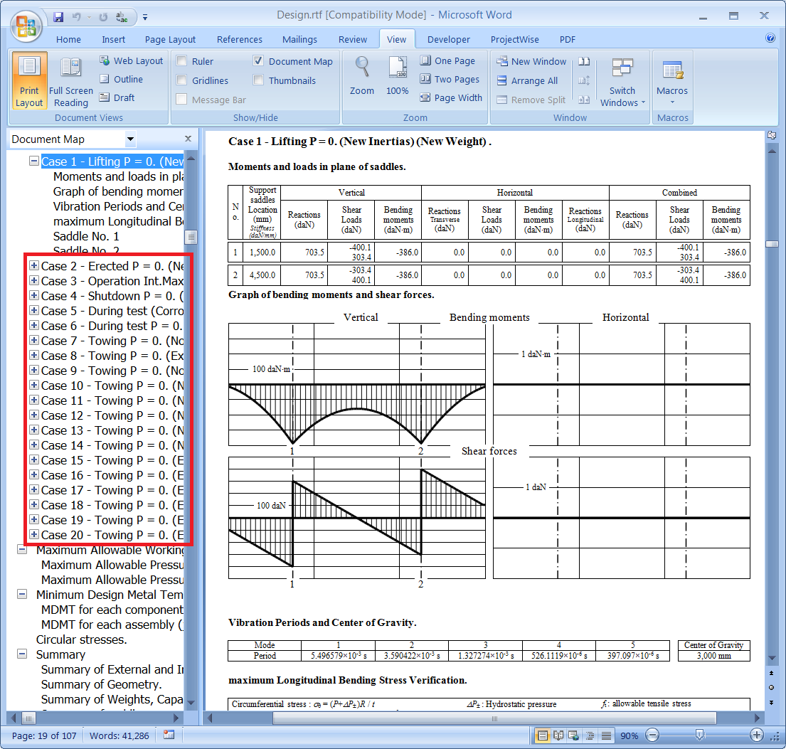

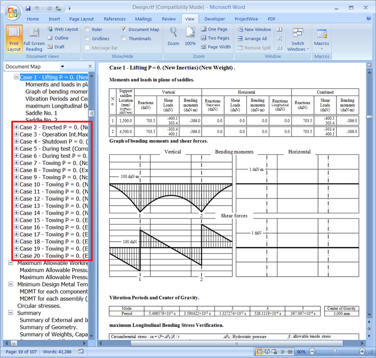

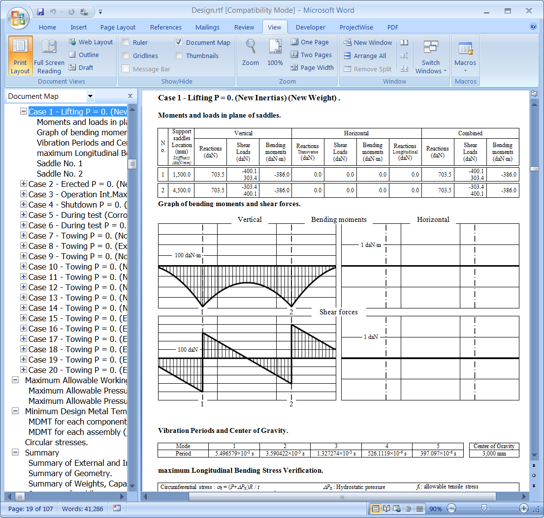

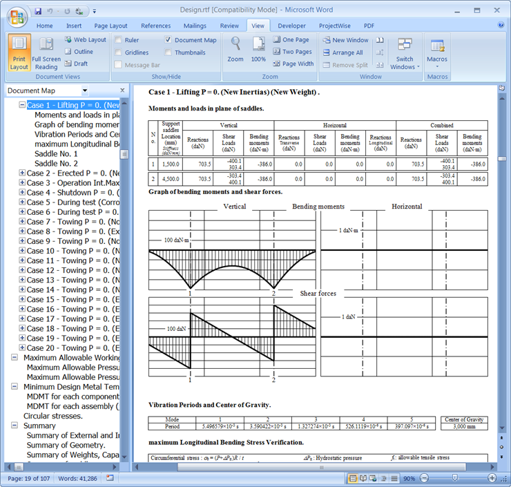

  33. Perform a strength calculation by selecting Execute > Calculate Strength .
  34. Once the calculation has completed, select Execute > View Calculation Results .
  35. A full calculation report is generated using the Word Processing Software Executable defined in the Preference Properties dialog (in this example, Microsoft Word). Select the View tab, then enable the Document Map checkbox (or the Navigation Pane checkbox, depending on your version of Microsoft Word).
  36. From the Document Map (or Navigation Pane), select Case 1 - Lifting P = 0. (New Inertias) (New Weight). The calculations of the first defined Towing load combination are displayed in the calculation report.
  37. The other defined Towing load combinations are also available within the calculation report.

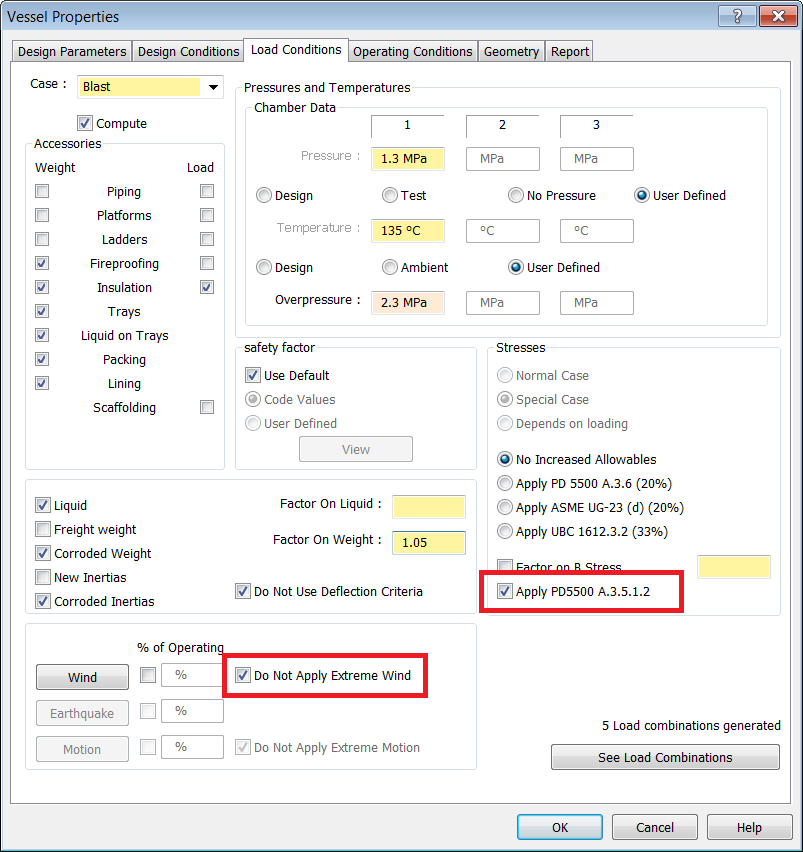

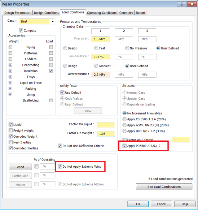

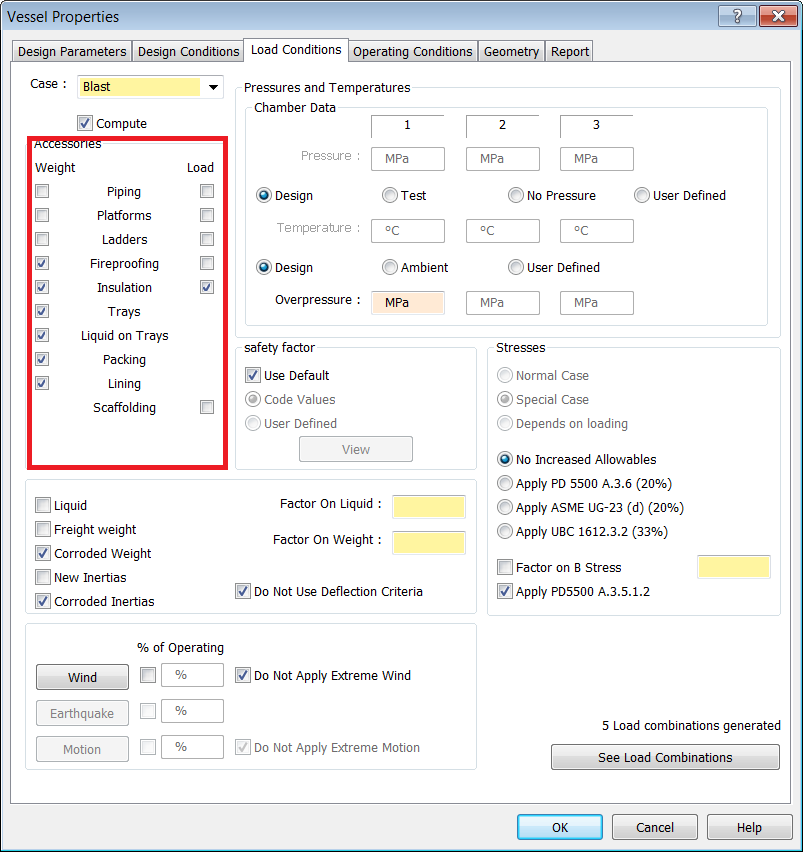

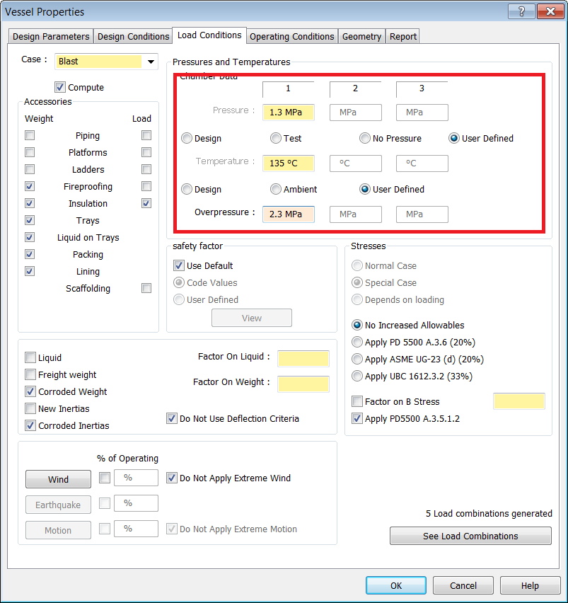

  8. Select the Load Conditions tab, then select Blast from the Case drop-down pick-list.
  9. Enable the Compute checkbox to set the combined cases to be generated/calculated and to enable the fields within the Load Conditions tab
  10. Enable the Weight checkbox for Fireproofing, Insulation, Trays, Liquid on Trays, Packing, and Lining accessories.

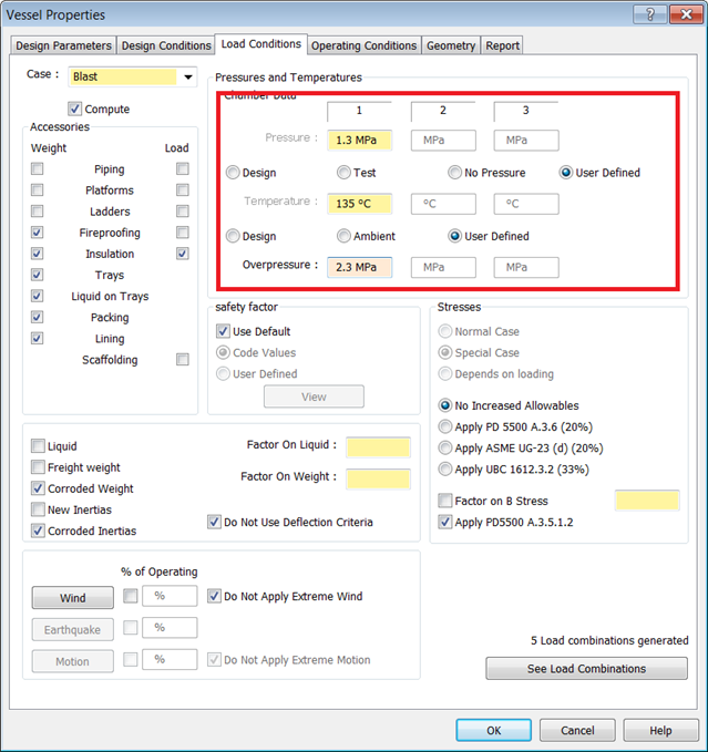

  11. Enable the Load checkbox for Insulation accessories.
  12. To specify a custom pressure value, enable the User Defined radio button, then type 1.3 in the Pressure field.
  13. To specify a custom temperature value, enable the User Defined radio button, then type 135 in the Temperature field.
  14. To define a Blast overpressure, type 2.3 in the Overpressure field.

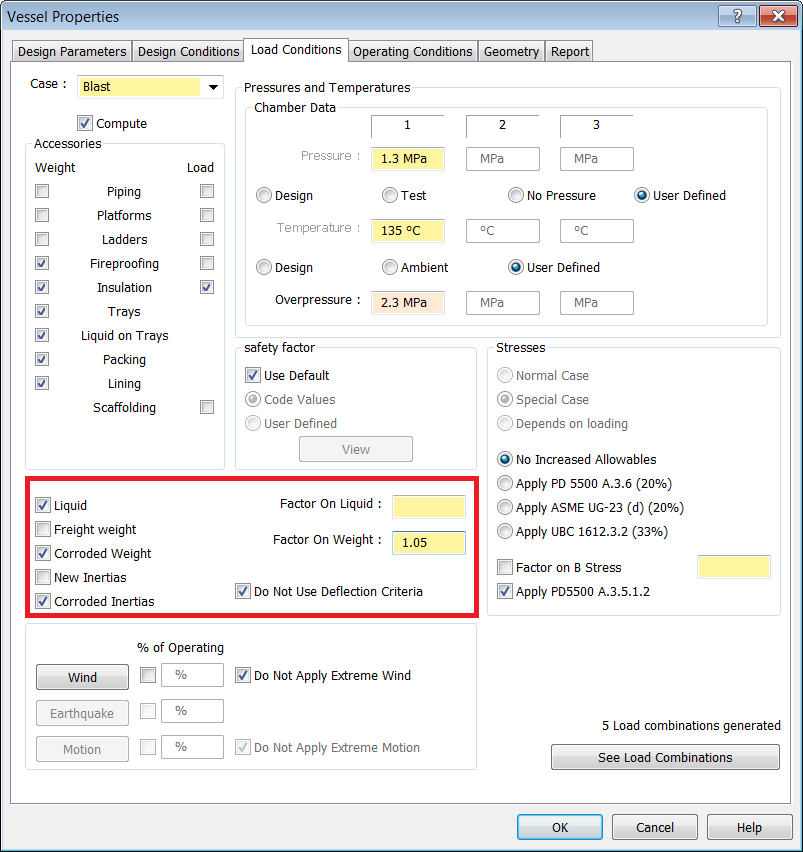

  15. Define the Vessel as containing liquid by enabling the Liquid checkbox.
  16. Enable the Corroded Weight checkbox. Corroded Weight means that the thicknesses used to compute the weight will be corroded (so less weight is considered).
  17. Enable the Corroded Inertias checkbox. Corroded inertia means that the thickness used to compute inertia will be corroded (so less inertia is considered).
  18. To apply a weight factor on the foundation loads, type 1.05 in the Factor on Weight field.
  19. Enable the Apply PD5500 A.3.5.1.2 checkbox to calculate the design values of longitudinal compressive stress and external pressure in the cylindrical section.
  20. For this example, you will not apply extreme wind conditions. Enable the Do Not Apply Extreme Wind checkbox.

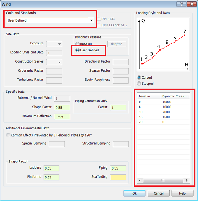

  21. You will now define the wind loads on equipment and other components such as piping and walkway. Press Wind to display the Wind dialog.
  22. Select User Defined from the Code and Standards drop-down pick-list to define a custom wind condition.
  23. Define Dynamic Pressures by enabling the User Defined radio button, then define the Level m and Dynamic Pressure as shown below.
  24. Press OK.

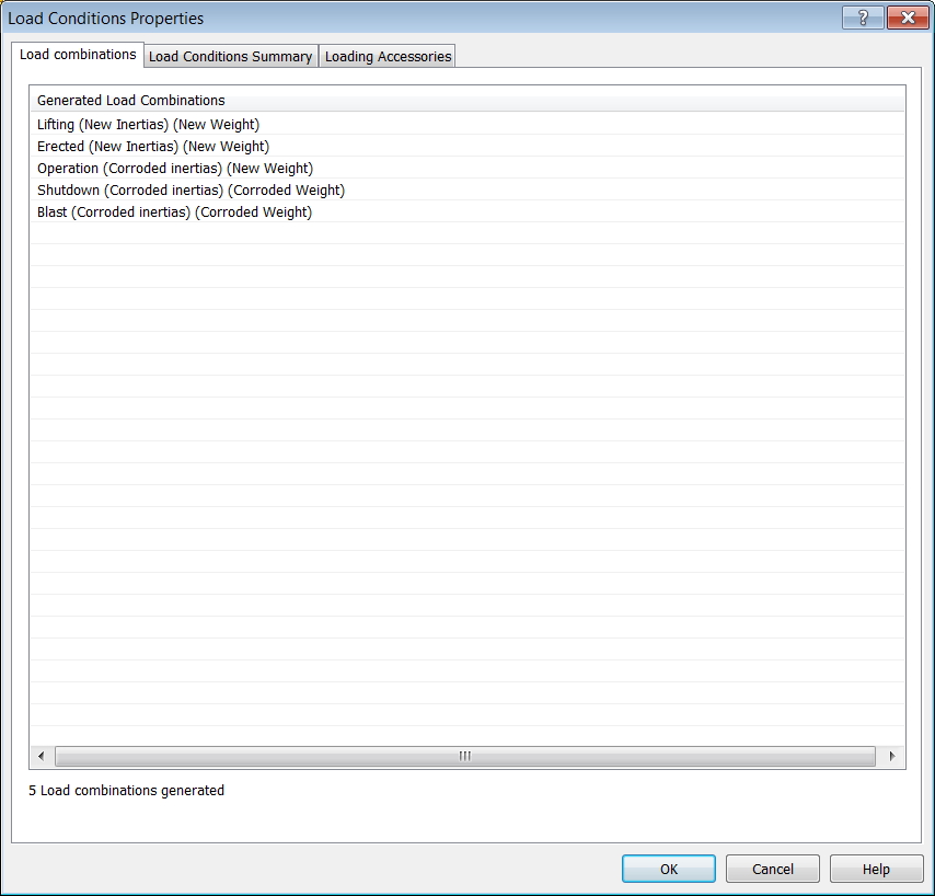

  25. Press See Load Combinations to display the Load Conditions Properties dialog.
  26. Select the Load Combinations tab, which presents a summary of all defined load combinations.
  27. Notice that 5 load combinations have been defined. Press OK to return to the Load Conditions tab.

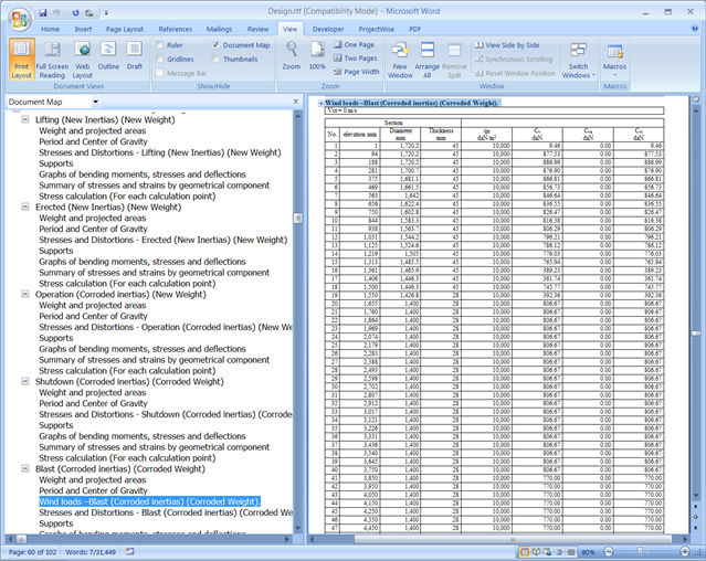

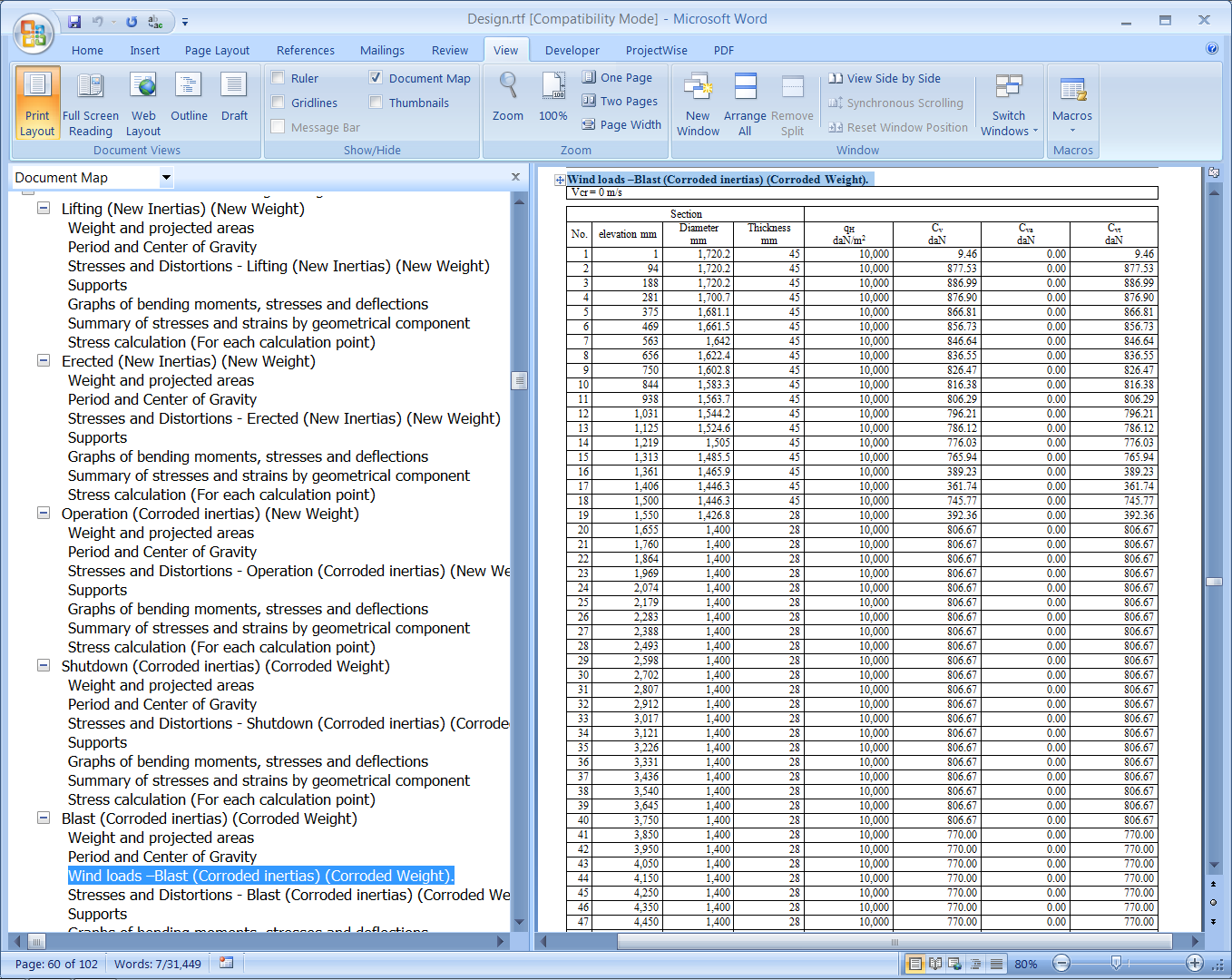

  31. Once the calculation has completed, select Execute > View Calculation Results .
  32. A full calculation report is generated using the Word Processing Software Executable defined in the Preference Properties dialog (in this example, Microsoft Word). Select the View tab, then enable the Document Map checkbox (or the Navigation Pane checkbox, depending on your version of Microsoft Word).
  33. From the Document Map (or Navigation Pane), expand the Vessel under combination loading - Design case section, then expand the Blast (Corroded inertias) (Corroded Weight) section.
  34. Select Wind loads – Blast (Corroded inertias) (Corroded Weight). Calculations of the defined Blast wind load combination are displayed in the calculation report.
  35. The other defined Blast load combinations are also available within the calculation report.
