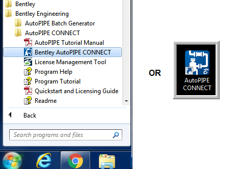

1. Start AutoPIPE by double clicking on the desktop icon or from the Start Menu> Bentley Engineering>  AutoPIPE Connect

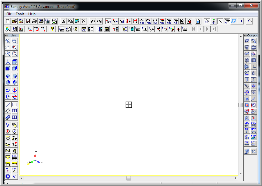

2. The following windows will now appear on screen:

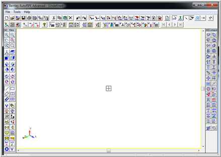

a. AutoPIPE application window:

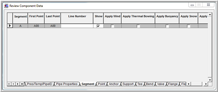

b. Input grids window:

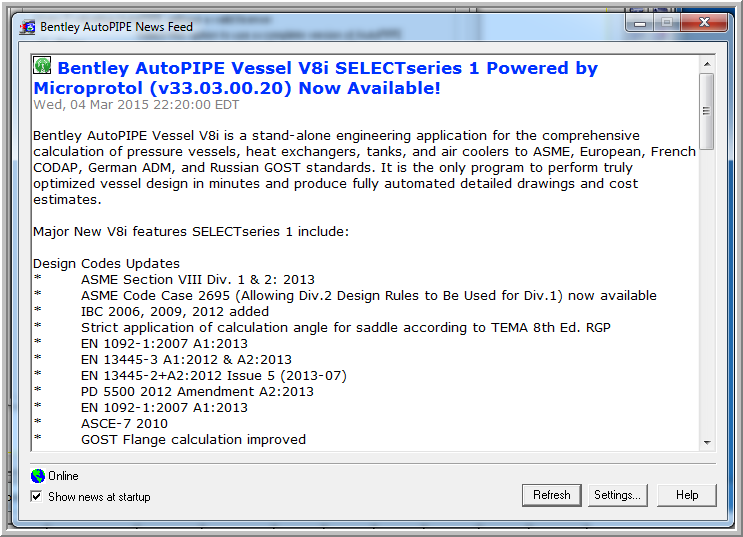

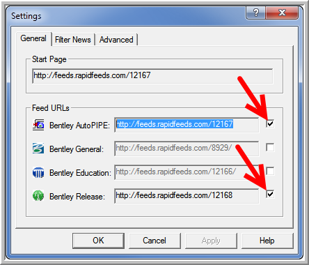

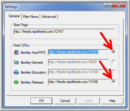

c. Bentley AutoPIPE News feed (default setting):
Note: On the Bentley AutoPIPE News Feed, recommend pressing Settings button, then place a check mark for Bentley AutoPIPE & Bentley Releases.

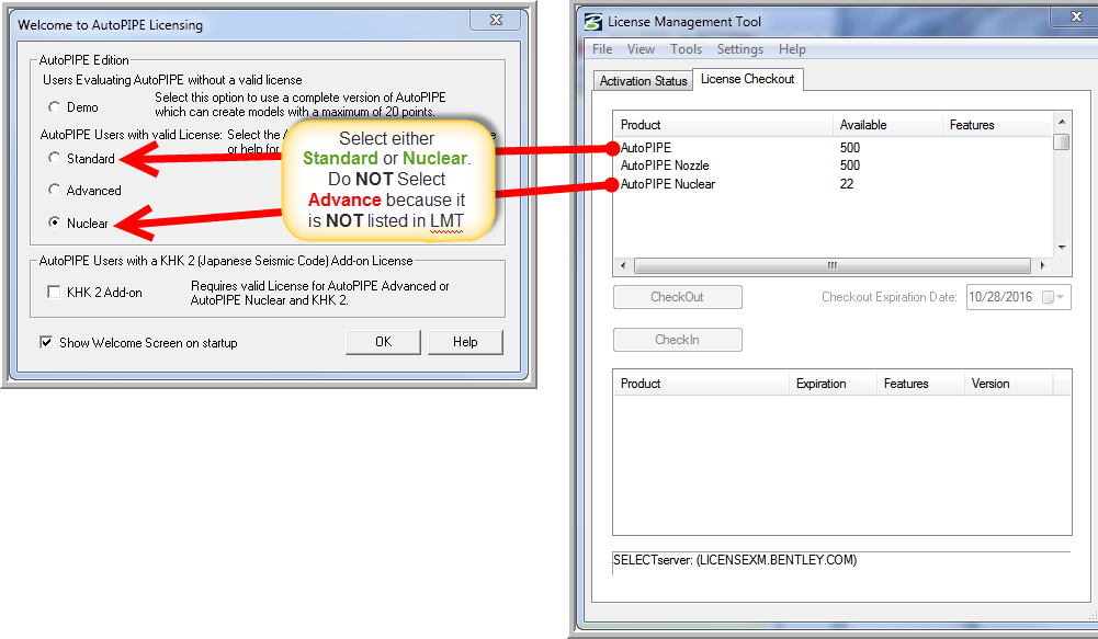

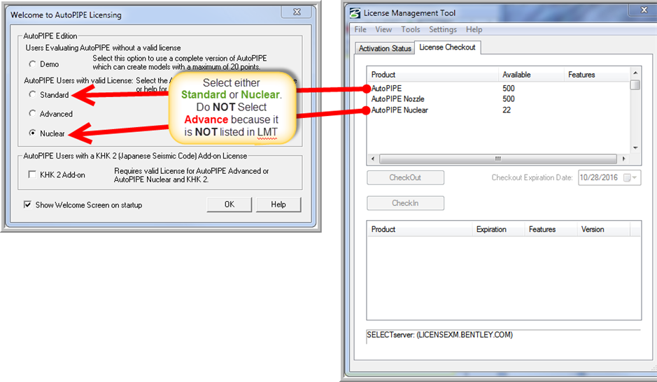

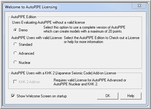

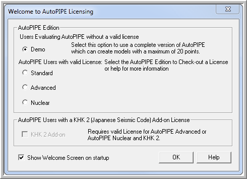

d. Welcome to AutoPIPE Licensing (default setting = Demo), Select an edition to license:
Note: On the Welcome to AutoPIPE Licensing screen, press the radio button in front of the type of AutoPIPE edition to be used (i.e  Standard, Advanced, or Nuclear)
+++important+++ Suggest only select editions displayed in LMT and press OK button. Otherwise you may log over-usage.
Press OK button to continue.
If the program reverts to TRIAL mode or DEMO mode click here.
Note: If your license contract has the add features, KHK 2 Add-on, you can also select that radio buttons in addition to the AutoPIPE version radio button.
After pressing OK button, the application will look at LMT, checks available license for the product selected.  If available, the application will be licensed and ready to be use.

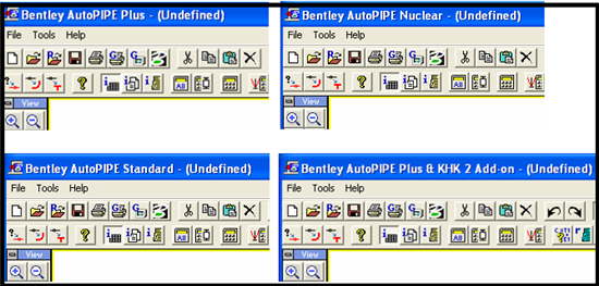

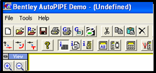

To verify the application has a valid license, the top application bar will have one of the following:
HOWEVER, if a valid license was not available, the application will revert to DEMO mode, as indicated by:
If revert to demo,

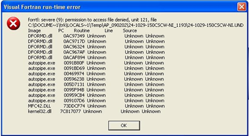

3. Visual Fortan run-time error; forrtl: sever (9) permission to access file denied
During installation or while using the application the following error appears:
The problem with reading/writing this file can be caused by
a. User having no access to this folder (folder is read only)
b. File is read only, check file properties
c. No disk space on drive C: where temp folder is located
d. Change settings in the antivirus to exclude AutoPIPE and also .UND files.
