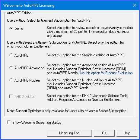

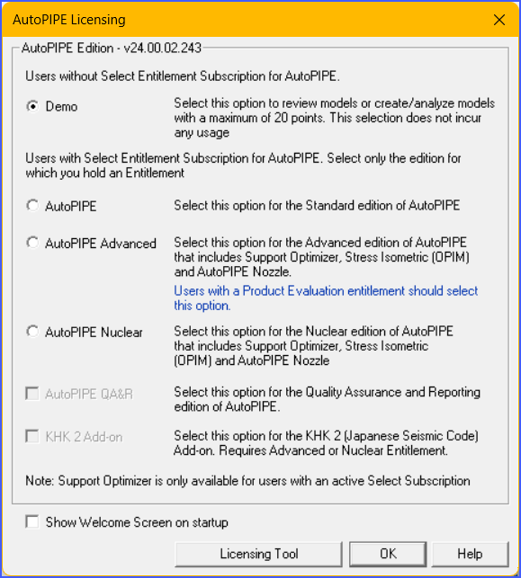

AutoPIPE 23.x and higher:

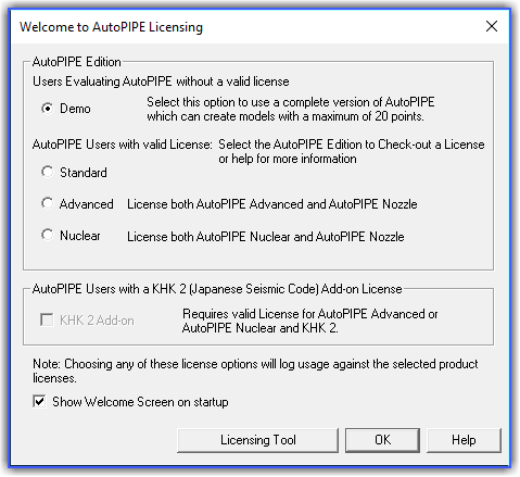

AutoPIPE 12.03 and 12.08:
Note: The Blue wording on the dialog above is meant only for those wishing to evaluate the program. The wording does not apply to general licensing. After receiving the Evaluation license entitlements, only select AutoPIPE Advance edition to evaluate the available features. The other options, Standard and Nuclear, will not work for the evaluation period.
