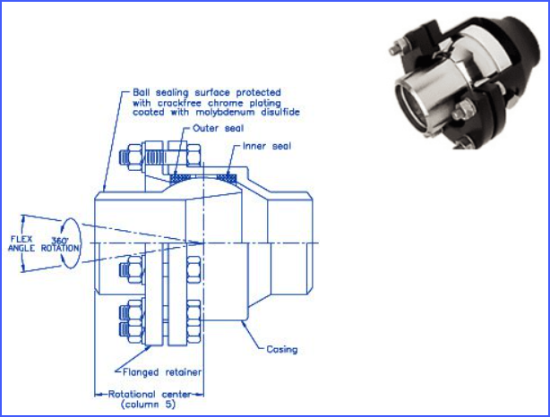

How to model manufactured Ball/Socket assemblies from:
1. Hyspan Barco Ball Joint
(Manufactures site)
or
2. EBAA Iron Sales, Inc. FLEX-TEND® Flexible Expansion Joints
(manufacture site)
 The concepts mentioned AutoPIPE's help can be adapted to model most ball and socket assemblies manufactured. See the following AutoPIPE help section for modeling technique:
Help > Contents> Contents Tab> Modeling Approaches> Modeling Approaches> Flexible Joints> Ball and Socket Joint example in AutoPIPE's online help.

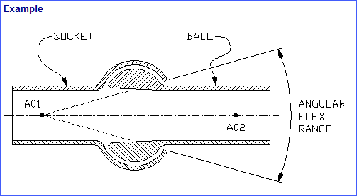

Actual ball and socket joints are limited in their range of angular rotation (shown below). AutoPIPE can model these joints with or without movement limitations. Therefore, they should be placed in the piping system and checked to confirm that ball Joint Manufacture limits are not exceeded.

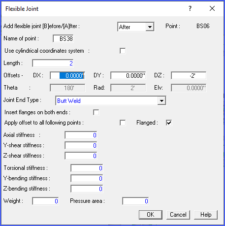

Question:  In AutoPIPE, a ball-and-socket joint is modeled as a Flexible Joint. Which Flexible Joint stiffness values on the dialog correspond to the angular, torsional, and axial motion indicated by the image above?
Axial, Shear, Torsional, or Bending?
Answer: Correct...
Refer to KB article here for detail understanding of this dialog.

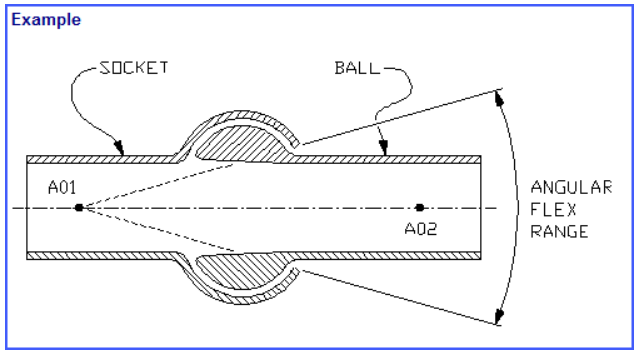

Question #1: At which node point should a rotational support be inserted: A01 or A02?
Answer:
The rotational support should be placed at A02, Why?
Because, A01 is the main housing of the ball and it is A02 that will actually rotate the angular distance. Therefore, A02 is the proper locations to insert the rotational support.
Question #2: How many rotational supports are placed at one location ( ex. A02) to correctly model the angular rotation of the ball and socket joint?
Answer:
Minimum 2, Why?
Because, angular articulation happens in 2 planes, the Vertical Plane and the Horizontal plane perpendicular to the axis of the pipe. Make sure to enter both a clockwise and counterclockwise gaps for the amount of movement allowed by the manufacture.

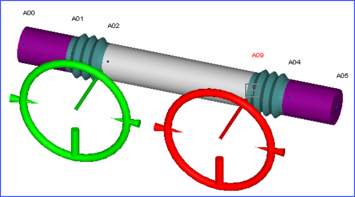

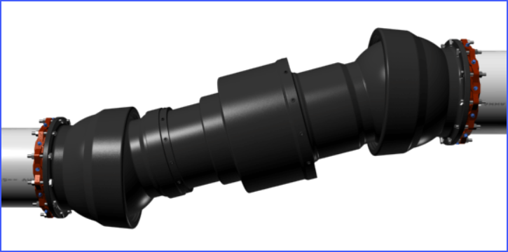

Specific to EBAA Iron Sales, Inc. FLEX-TEND® Flexible Expansion Joints, one would model back to back Flexible Joints and add the rotational supports as imaged below:
Axial expansion
Specific to EBAA Iron Sales, Inc. FLEX-TEND® Flexible Expansion Joints, the assembly includes a special expansion and contraction joint located at the center of the assembly. To properly account for this movement and restraining in AutoPIPE, model an additional Flexible joint whose length is equal to the expansion/contraction length of the joint (ex. A06 to A07). Set the shear and bending stiffness to Rigid, while keeping the axial and torsional stiffness low. Next, to restrain the axial movement, insert a line stop at the end of this new flexible joint (ex. A07) that is "Connected to" the opposite end of the joint (ex. A06). Be sure to input the gap settings specified by the manufacturer. This will correctly account for the axial moment allowed by the assembly.
