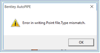

"Error in writing Point file.Type mismatch... " message appears in AutoPIPE , why?
Product(s): AutoPIPE
Version(s): ALL;
Area: Error Message
Date Logged
& Current Version
April. 2018
11.03.00.08
The following appears in AutoPIPE when exporting a model input listing:
OK
Why and How to resolve?

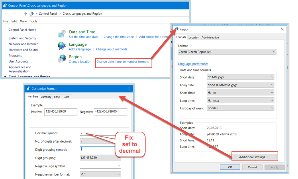

One reason why this message may be displayed was because the Windows decimal symbol was changed from "period " to "comma". This has been loogged as a defect and will be fixed in a future version of the application.
Workaround:
Change Windows Decimal symbol format from "Comma" to "Period"
