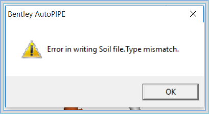

The following appears in AutoPIPE when exporting a model input listing:
Error in writing Soil file.Type mismatch.
OK
Why and How to resolve?

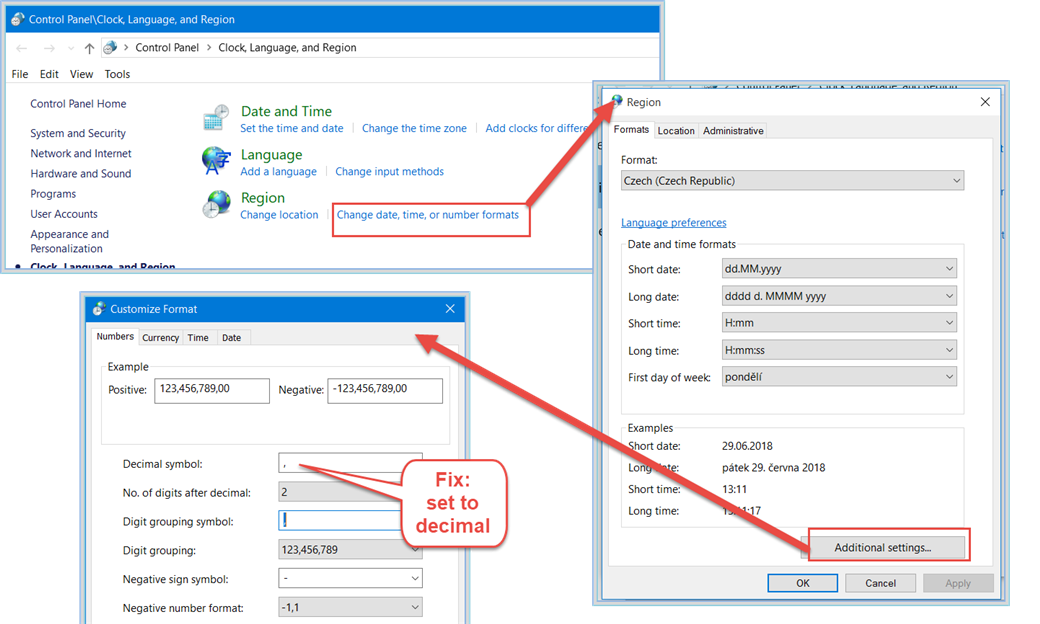

One reason why this message may be displayed was because the Windows decimal symbol was changed from "period " to "comma". This has been loogged as a defect and will be fixed in a future version of the application.
Workaround:
Change Windows Decimal symbol format from "Comma" to "Period"
