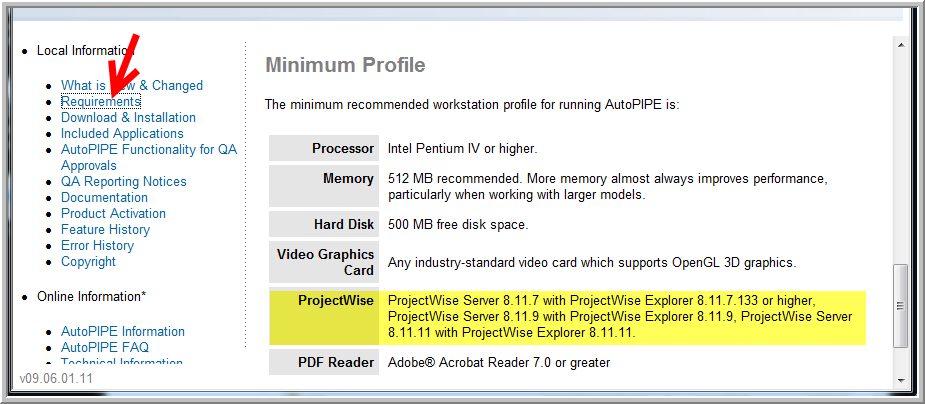

What version of AutoPIPE is compatible with which version of ProjectWise?
 Please see the AutoPIPE version you are using readme file (ex. autopipe_readme.chm); typically located in the same folder as AutoPIPE was installed:
a. C:\Bentley\AutoPIPE\
or
b. C:\Program Files (x86)\Bentley\AutoPIPE CONNECT

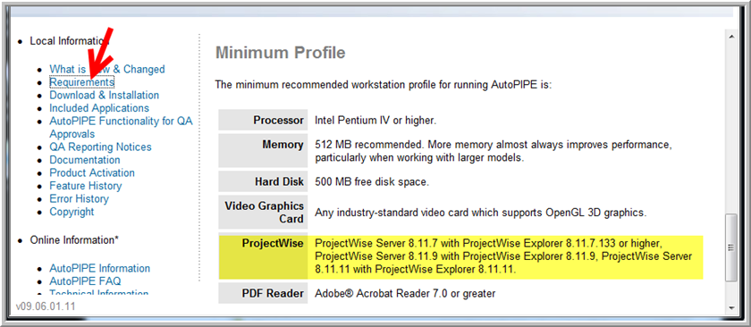

In the AutoPIPE readme file review the Requirements section, Minimum Profile, this will have the version of ProjectWise that that version of AutoPIPE was tested for. Other versions of ProjectWise are not currently supported.
Note: Image above was taken from AutoPIPE V8i 09.06.01.11.
If you are using a higher version of ProjectWise then mentioned here in the readme file, please log a Bentley Service Request and mention this WIKI page.
