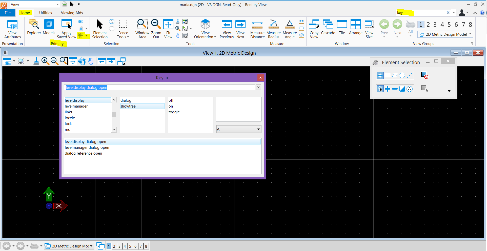

In MicroStation there is a series of icons available by defaults to open these dialog boxes but in Bentley view CONNECT or other editions like V8i we need to use key in commands to launch these dialogs.
You can open the key in dialog from Home menu \primary \more\key in or by typing in the search box: key in also by selecting the key in button directly from the ribbon
1. To open the Level Manager->key in: levelmanager dialog open
2. To open the Level Display ->key in: leveldisplay dialog open
see image below
