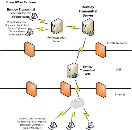

10) My server is in a DMZ, what ports need to be open on the firewall?
When you configure your BTS Server you configured a net.tcp binding on your IIS Web Site, the port you chose to use is the port that is used from the Portal Server to the Transmittal Server and continuing to the ProjectWise Integration Server.
When you configure your Bentley Transmittal Portal, you similarly configured an IIS Web Site, this time with an https binding. This port is what users will connect over when accessing the portal through their web browser
​PWE:
PWIS:
​​BTS:
Portal:
