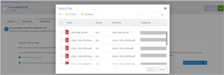

Deliverables Management integration with ProjectWise Web Connections service
To integrate ProjectWise Web with ProjectWise Deliverables Management, all you have to do is add one or more work area connections in the ProjectWise Web portal of the same ProjectWise project where you are using ProjectWise Deliverables Management. Once a work area connection exists in ProjectWise Web, ProjectWise Deliverables Management portal users can start adding documents from that work area connection to their transmittal drafts.

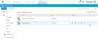

By going to the Issue Resolution Service or Forms Manager of the same project, the administrator can now:
When you are managing forms, you might see two versions of the default 'Submittal Issue' form, depending on whether or not your users have already created issues using the previous, un-editable version of the default 'Submittal Issue' form:
If your users never used the old, un-editable version of the Submittal Issue form, then you will only see one version of the form in the list - Submittal Issue (the old form is replaced by the new form of the same name, whose status is Approved).

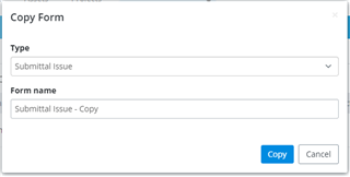

To make a copy of an existing submittal issue form:
  1. Click the Copy button in the Actions column next to the form you want to make a copy of.
  2. In the Copy Form dialog, set Type to Submittal Issue, enter a name for the form in the Form name field, and click Copy.

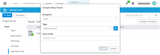

To create a new submittal issue form:
  1. Click the New button.
  2. In the Create New Form dialog, set Discipline to Issue, set Type to Submittal Issue, enter a name for the form in the Form name field, and click Create.

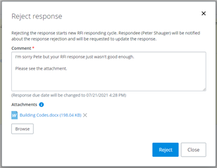

Sending an attachment back with your rejection of an RFI response
If you need to reject the incoming response for your outgoing RFI, you can now attach a document to send back along with your rejection of the response.

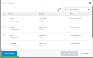

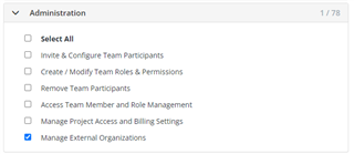

Inviting External Organizations to your ProjectWise project
From now if a user wants to invite External Organization to their ProjectWise project from within Deliverables Management package draft - they will need to hold Administration "Managed External Organizations" role permission in Team Members management page.
