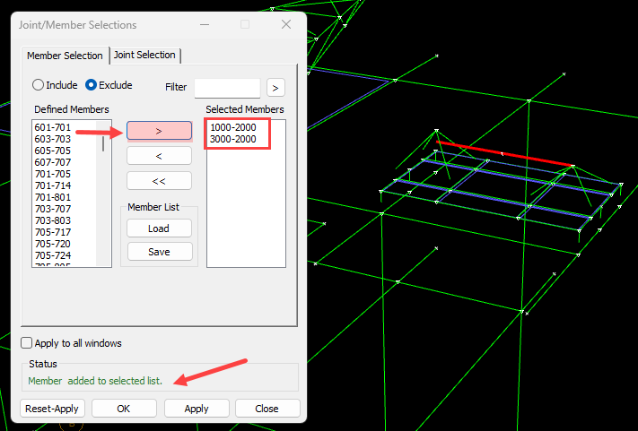

In Joint/Member Selections, when selecting members, the "Filter" box can only input maximum 4 digits, while in order to select a member 9 digits should be available. Is this a bug? Please advise.

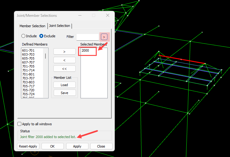

User can filter the member consisting of selected joints (joint A or joint B). Users can either select multiple members from the 'Defined Member' box or use the Filter option.
If user use the Filter option as below, SACS will filter the joint number connected the members, so all members connected to the joint will be selected.
