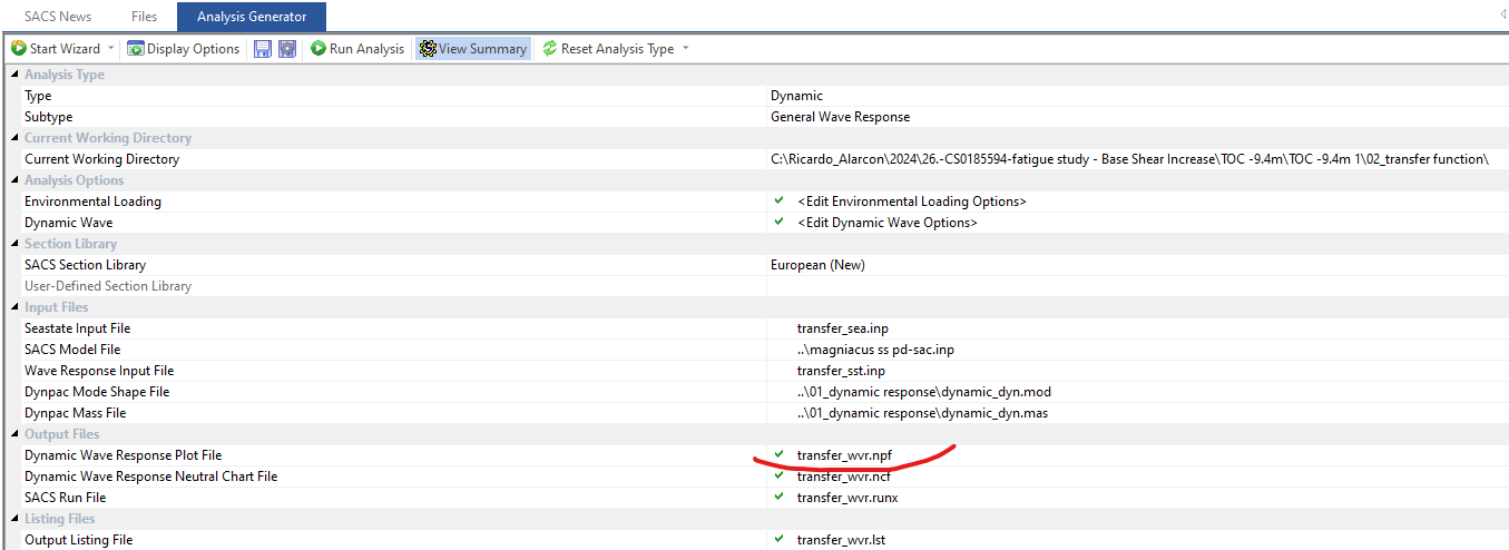

I am doing dynamic response analysis and hope to obtain modal acceleration in Transfer Function Plot vs Periods.  I would like to know in which file can I find these plots?
Answer:
you can see the plot in the file .npf file generated during the analysis Dynamic Wave response
In the .npf file, you can find the transfer function vs period plots for Overturning moment and base shear
