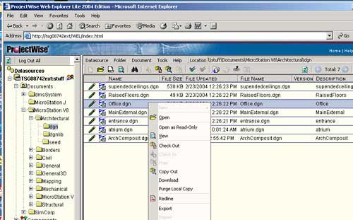

The ProjectWise Web Explorer Lite application window has added a menu bar, a standard toolbar and an address bar. The menu bar and toolbar were added to the document and the document pool frame, while the address toolbar displays the full folder path to the selected folder or document (See Figure 1).
A new toolbar at the top of the datasource list allows you to refresh the list, as well as to log out of all datasources.
Support for standard document selection
ProjectWise Web Explorer Lite 2004 Edition has removed the check boxes for selecting multiple documents. The document list now supports standard click, ctrl-click, and shift click actions for selecting single or multiple documents.
Function selection
The appropriate tool icons and menu items will be enabled or disabled based on the version number and state of the documents selected. The most commonly used functions will be presented on the toolbar. All other functions will be listed on the menu.For quick access, you can right-click any item in the documents window and choose items from the menu that appears. Items on right-click menus correspond to items on the menu bar, or in one of the toolbars.

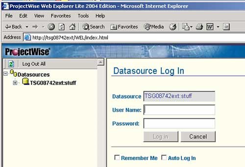

The ProjectWise 2004 Edition includes "Remember Me" and "AutoLogin" options when logging in (Figure 2).
The information for these options is stored in a cookie on your local workstation. The Remember Me option will pre-fill the username and password information when your return to the login page. The AutoLogin option will log you directly into the datasource using the stored information. If your administrator would like to disable these options, they can do so by editing the PWLiteServlet.properties file located on the ProjectWise Web Server.
Figure 3

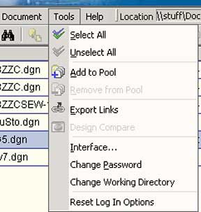

The ProjectWise Web Explorer Lite 2004 Edition Tools menu has an option that allows you to modify a password, as well as to change the AutoLogin and Remember Me options for your client machine using the Reset Log In options menu item (Figure 3.).

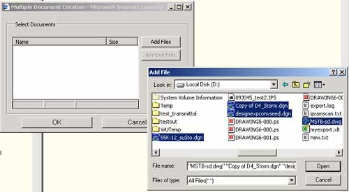

You can create a single file by browsing to it on your local machine. This process is very similar to the ProjectWise Explorer methodology for creating a new document from a desktop file. You can upload and create more than one document at once with the Multiple Documents option. For each file you select from your desktop, a document will be created in your ProjectWise datasource. A dialog will prompt you with an Add Files button. You will also be presented with a multi-file selection window (Figure 6).
Figure 6

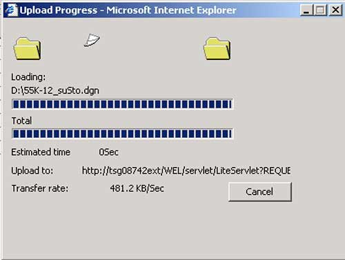

The Create Multiple Documents dialog allows you to drag and drop files from Windows Explorer to the Name Display section of the Multiple Document Creation dialog box. When you click the OK button, the upload begins and the document creation process is started. ProjectWise Web Explorer Lite 2004 Edition shows a status dialog of the file being processed and the estimated time left (Figure 7).

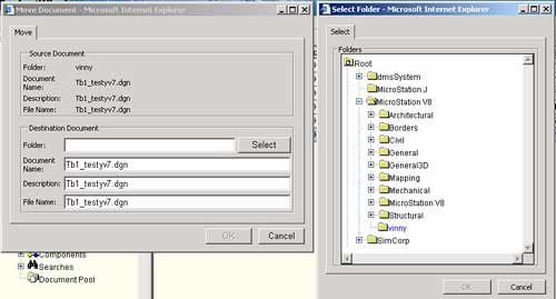

See Figure 8 for an example of the Document Move command. It presents you with a folder selection dialog and options to change the Document Name, Document Description, and Document File Name.

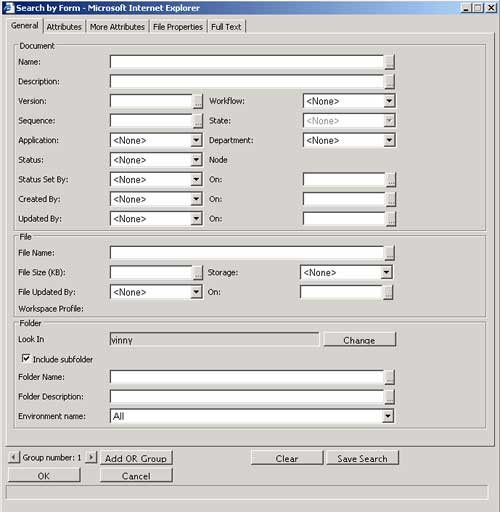

In ProjectWise Web Explorer Lite 2004 Edition you can search for documents based on any general property and/or environment attribute. If the new ProjectWise 2004 Edition capabilities for file properties and full text searching capabilities have been configured for the datasource by your administrator, you can also search for documents based on those criteria. When you initiate a search, all documents and document sets that match your search criteria are returned and listed in the documents list frame.
Figure 9: To search for documents based on general properties, use Search by Form
The easiest way to use this dialog box is to enter your search criteria in the various fields on the various tabs, then click OK. You can also right-click in any text field in the Search by Form dialog box to open a menu which contains standard Windows options, such as Cut, Copy, Paste. The (...) button to the right of each text field opens the Format Criteria dialog box, which lets you enter more complex search criteria using comparison operators.

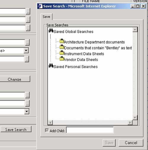

The 2004 Edition now allows you to save your search criteria (Figure 10) and to reuse it for subsequent searches. When you select a saved search, the search is automatically initiated based on the criteria previously defined in that search.

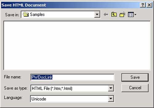

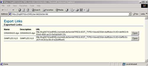

Exporting Document Links - Every document stored in ProjectWise includes a link, allowing you to access it from Internet Explorer. The link contains a global unique ID, so no matter where a document moves inside ProjectWise, its link will always be valid. By selecting a document or several documents you can use the Tools menu to export the links to an HTML page (see Figure 11). You will also see an Export Links List dialog showing all the links to the files you selected.

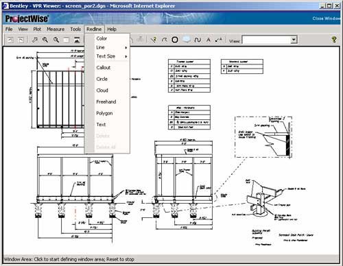

Redlining Documents - With ProjectWise Web Explorer Lite 2004 Edition, you can redline documents of many formats. Once a document is redlined you can view it, or open it for further changes. Non-DGN or non-engineering documents (MicroSoft Office) are redlined with Markup Manager for the Web. Markup Manager for the Web converts the document to an HTML document for display and provides tools for markup. Redlining DGN, DWG, and DPR file types are done using the VPR Viewer in conjunction with Bentley Publisher (Figure 13).
