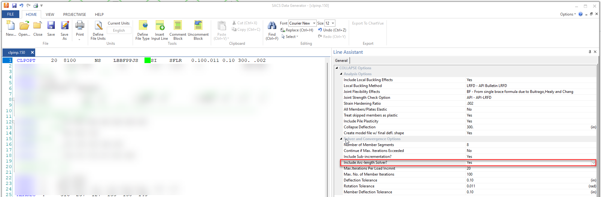

The Newton-Raphson Theory is used by default as a first resource to reach the convergency in this type of analysis, If this formulation is not sufficient to achieve convergence you can add the Arc-Leng solver once time that all possibilities have been exhausted using Newton-Raphson. You can Active the Arc-Leng solver in columns 44-45 of the card CLPOPT

once the convergency is not achieved using Newton Rapshon, SACS can use the Arc-Length method to get the convergency. There are two types of arc-length iteration methods available in Collapse Advanced. cylindrical (CYL) and spherical (SPH).
The arc-length solver may be used for post-buckling analysis by specifying the analysis option 'AL' in columns 42-43 in card CLPOPT.
The cylindrical method uses deflection increments to determine the arc-length parameter while the spherical arc-length method utilizes a factor (columns 31-36) to combine both force and deflection increment. The automatic arc-length parameter can be scaled by a factor in columns 24-29 in card ARCLEN (the default value is 1.0) – i.e. if the arc-length parameter is too large, a value smaller than 1 can be entered or vice versa.
The arc-length method also utilizes a sub-incrementation scheme if it is required. If this option is left blank (i.e. default), Collapse Advanced will attempt to solve using the following order:
